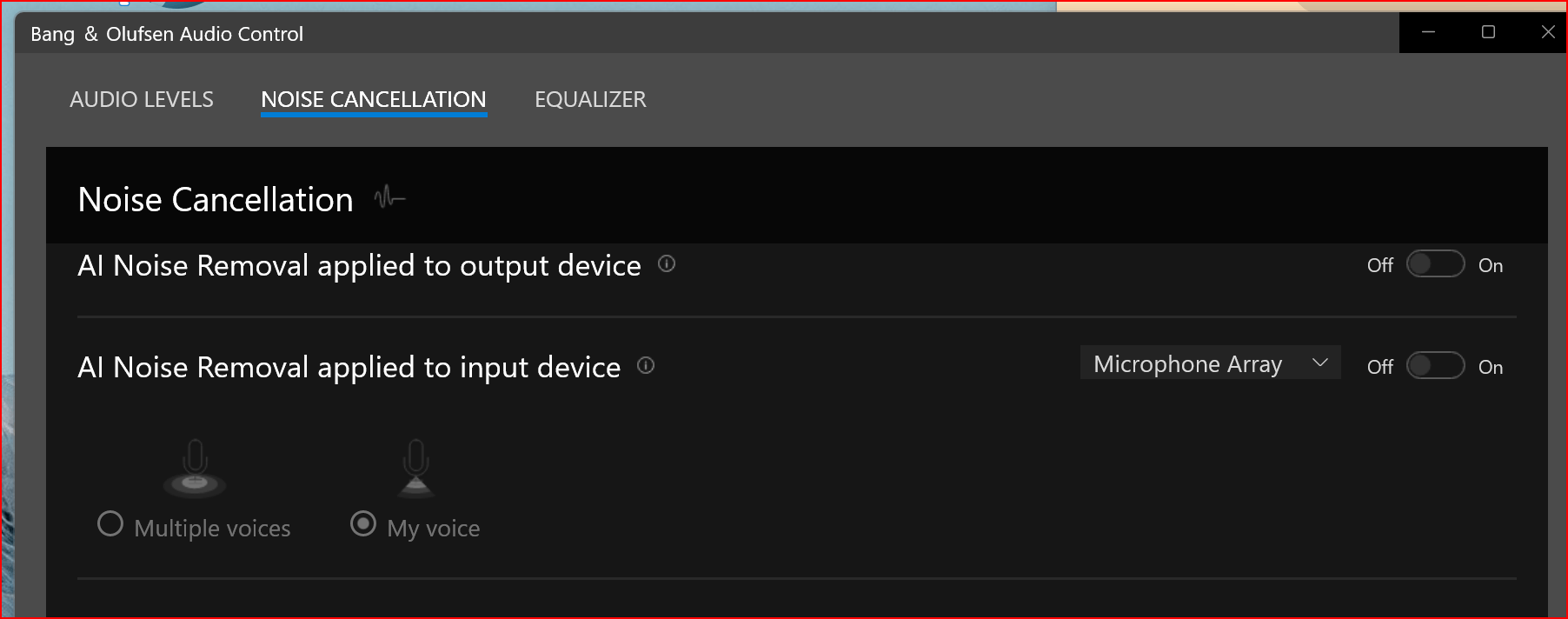

    This is all very good news. I just bought the 34" HP Envy, and it is a beautiful machine, but the sound of my violin was cutting out during my Zoom lessons. After seeing Erop and Paul's conversation, I looked for an app and found that there was a Bang & Olufsen app on my machine. I turned off all noise cancellation on the app for all of my microphones and then tested them on Zoom. Now my sound is completely back. Then I set the equalizer for music. Probably don't need that for violin because it basically raises the bass, but maybe I'll take up bass guitar now. Now I think I'll set everything else back to default and see if it still sounds good.

    Hi Jake, I found your question because I was working on a problem with my new 34" HP Envy AIO. It's a beautiful machine, but my violin lessons on Zoom were ruined by all of the violin sound being cut out by the noise suppression. The solution by the Microsoft Agent did not work, but at the very bottom of the comments, there was a posting that involved using the Realtec Audio Console app. I didn't have that app on my computer, but I found that I had the Bang & Olufsen Audio Control app. I used the B&O app to turn off noise cancellation on all of my microphones and then tested them under the audio controls on Zoom. All of the sounds were back. Maybe you can find a similar solution on your device.
