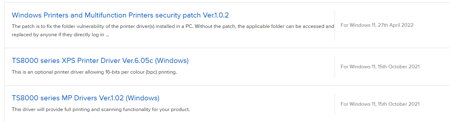

    Hi Robyn,
    thank you for responding. When I log onto the canon website there are 3 choices . See Below. I chose the second option. Is this correct?
  4. Deleted
