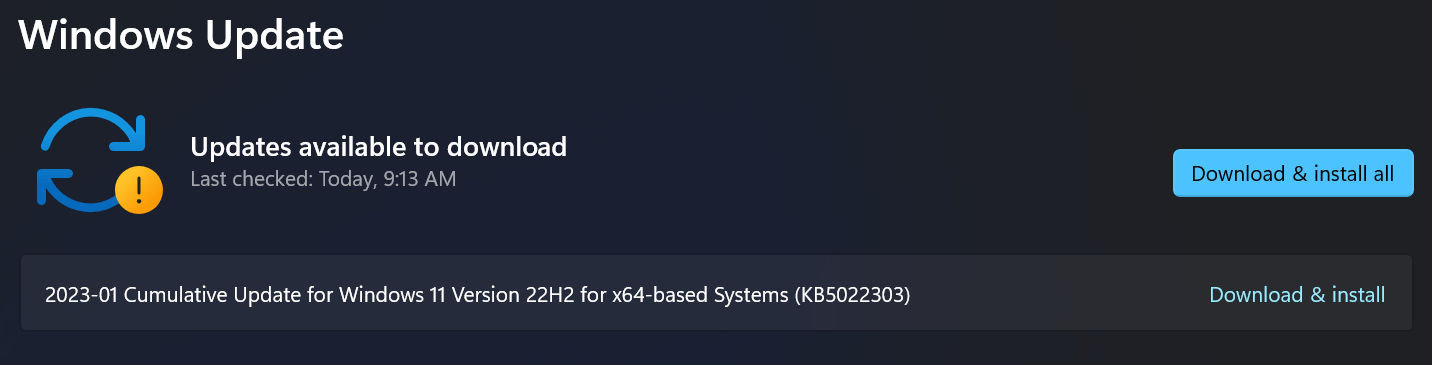

    2023-01-11T09:09:45+00:00
    The REG Fix was not working, the problem still exists, and finally I try installing using the ISO. there's no repair instalation anywhere on the setup so I just follow the wizards to install anyway while choosing to preserve my app & data.
    And after a long wait it's done, but the strange thing is, in the windows update setting, it shows like this
    But whenever I try to Download & Install, it just stop and never got through even the downloading step.
