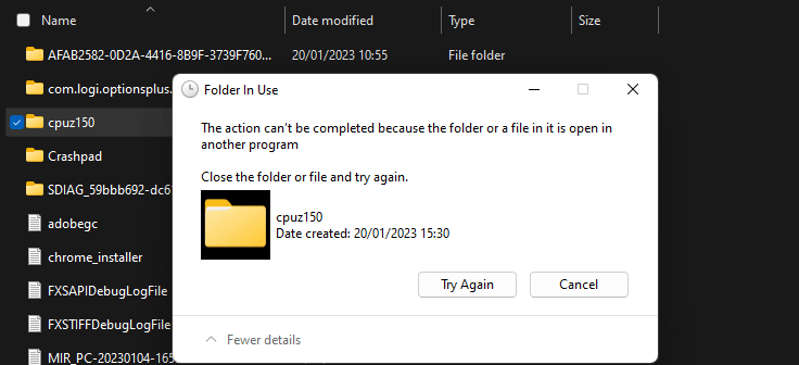

Don't know if it will help:
I already checked other posts, and I have not installed the CPUZ application.
I was able to locate this temp file, but I'm not able to delete it:

Ramesh Srinivasan
The event log tells that the last driver installation was done at 08:25:39 UTC time. So nothing has been installed in the last 5 hrs or so.
  • <Event xmlns="**http://schemas.microsoft.com/win/2004/08/events/event**">
  • <System> <Provider Name="Service Control Manager" Guid="{555908d1-a6d7-4695-8e1e-26931d2012f4}" EventSourceName="Service Control Manager" /><EventID Qualifiers="16384">7045</EventID><Version>0</Version><Level>4</Level><Task>0</Task><Opcode>0</Opcode><Keywords>0x8080000000000000</Keywords><TimeCreated SystemTime="2023-01-20T08:25:39.2452376Z" /><EventRecordID>24353</EventRecordID><Correlation /><Execution ProcessID="1368" ThreadID="9444" /><Channel>System</Channel><Computer>MIR_PC</Computer><Security UserID="S-1-5-21-329695934-4175040297-455591349-1001" /></System>
  • <EventData> <Data Name="ServiceName">cpuz150</Data><Data Name="ImagePath">C:\WINDOWS\temp\cpuz150\cpuz150_x64.sys</Data><Data Name="ServiceType">kernel mode driver</Data><Data Name="StartType">demand start</Data><Data Name="AccountName" /></EventData> </Event>
This SID is responsible for S-1-5-21-329695934-4175040297-455591349-1001 creating the service.
Check if this is your SID by running "whoami /user"
Disable all third-party services using MSCONFIG.
Run this command to delete the CPU ID service.
SC.EXE DELETE CPUZ50
In Autoruns, disable all 3rd party scheduled tasks:
Restart Windows.

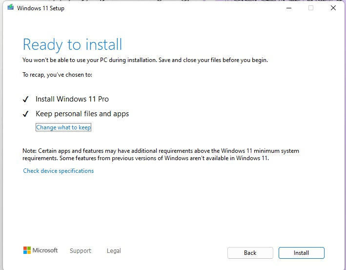

    2023-01-17T12:03:32+00:00
    Hi Dave,
    Looks like I procrastinated a lot, but anyway I tried to reinstall Windows using the windows 11 setup disk which I downloaded.
    So I chose to keep personal files and apps + install updates. The same problem happened and my device kept getting the blue screen error until I eventually uninstalled the update.
    Anyway I'm going to try reset but this time "keep personal files and remove apps". But just would like to make sure first, are any of these apps creating the problem?:
    Thanks!
  3. DaveM121 935.1K Reputation points Independent Advisor
    2022-12-18T09:12:47+00:00
    Hi MIR_05,
    If you are going to re-install Windows, that would definitely remove the problem and when you are re-installing your software, monitor your system in case one of those is causing that file to be generated.
