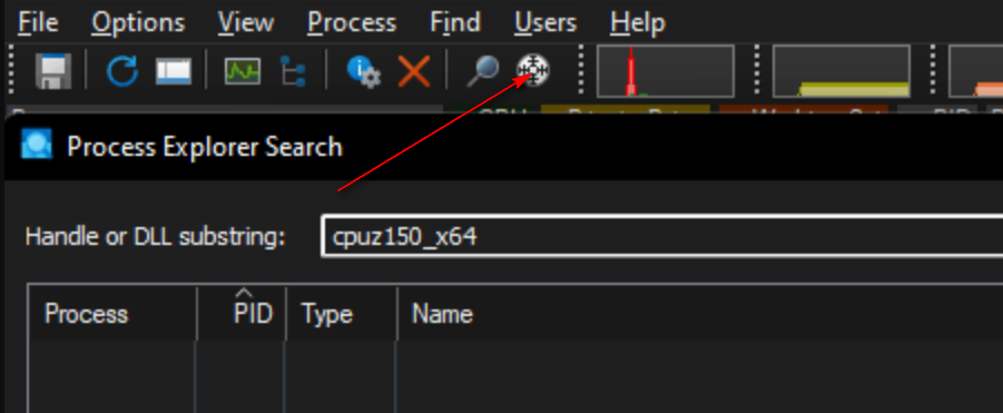

  2. DaveM121 935.1K Reputation points Independent Advisor
    2022-12-16T13:12:30+00:00
    Hi MIR_05,
    This is very strange, there is definitely some 3rd party software you have installed on your PC that is creating and using that CPUID file, the only know software is iCUE, and the only way I could see now for you to find the culprit would be to uninstall,, each 3rd party application, one at a time, until you find the software creating and using that file.
    2022-12-16T13:05:39+00:00
    Hi Dave,
    It just shows the windows explorer😭
  4. DaveM121 935.1K Reputation points Independent Advisor
    2022-12-16T11:54:11+00:00
    Hi MIR_05,
    Clear the search box, then open File Explorer so you can see the CPUZ file, then click and drag the icon shown below onto the CPUZ file, that should then show you what process is using that file.
