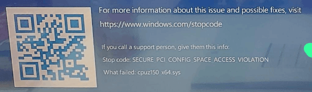

Here comes the problem, after about 2 minutes the computer suddenly shows the "your device ran into a problem...blah blah-to see the error code check the picture below-" and I have to shut down my PC.

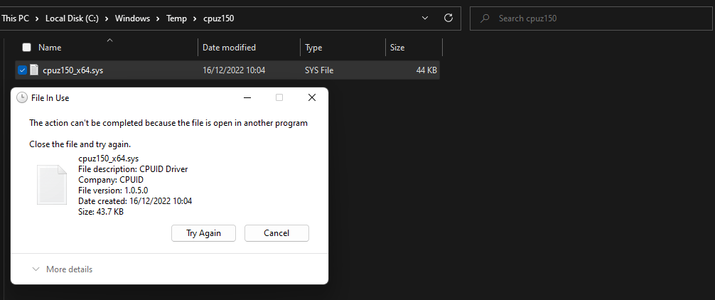

I was able to locate this temp file, but I'm not able to delete it:

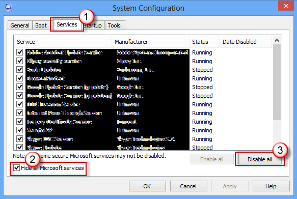

Disable all third-party services using MSCONFIG.

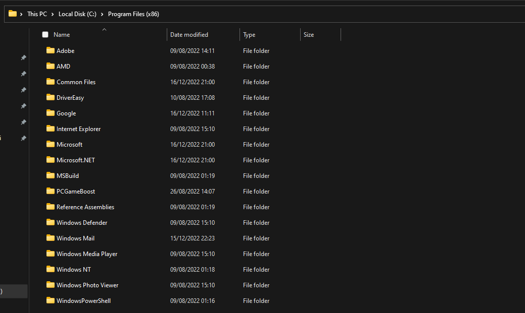

    Open File Explorer, then navigate to this folder:
    C:\Program Files (x86)
    Please provide a screenshot of the contents of that folder
