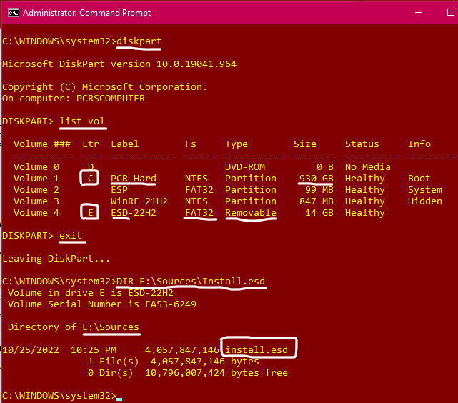

    (1) Make sure of the letters on the Windows partition & the USB Installation drive...
    (a) Plug in your Win 10 Installation USB flash drive. (Unplug all others.)
    (b) Boot to it using your BIOS Boot Menu F-key.
    https://www.sysnative.com/forums/threads/get-access-to-bios-settings-boot-menu-f-keys-hotkeys-by-system-manufacturer-oem.23010/ Get access to BIOS settings & Boot Menu: F-keys/Hotkeys by System Manufacturer (OEM)
    Press & hold the F-key at the manufacturer's logo screen (or at the black screen slightly before). It should then present a menu that includes the Installation USB drive (showing the name of the drive's manufacturer). If two are present, choose the one that says "UEFI", if yours is a UEFI installation. Otherwise, choose the other.
    (c) After it boots, click "Repair your computer" (instead of to install).
     This reboots to the external recovery environment of the Installation USB.
    (d) Click "Troubleshoot > Advanced options > Command Prompt".
      This reboots again to its Command Prompt.
    (e) Enter the following commands...
    DiskPart <<<Start DiskPart
    List Vol <<<List volumes & letters
    Exit <<<Leave DiskPart
    Identify the Windows partition by its label & size. The Installation USB drive should be FAT32 & the only Removable plugged in. Yours probably is labelled "ESD-USB". Are your letters C: & D:? Then enter...
    DIR D:\Sources\Install.wim <<<Does Install.wim exist? (I think not.)
    DIR D:\Sources\Install.esd <<<What about Install.esd? (That should exist.)
    Here is mine...
