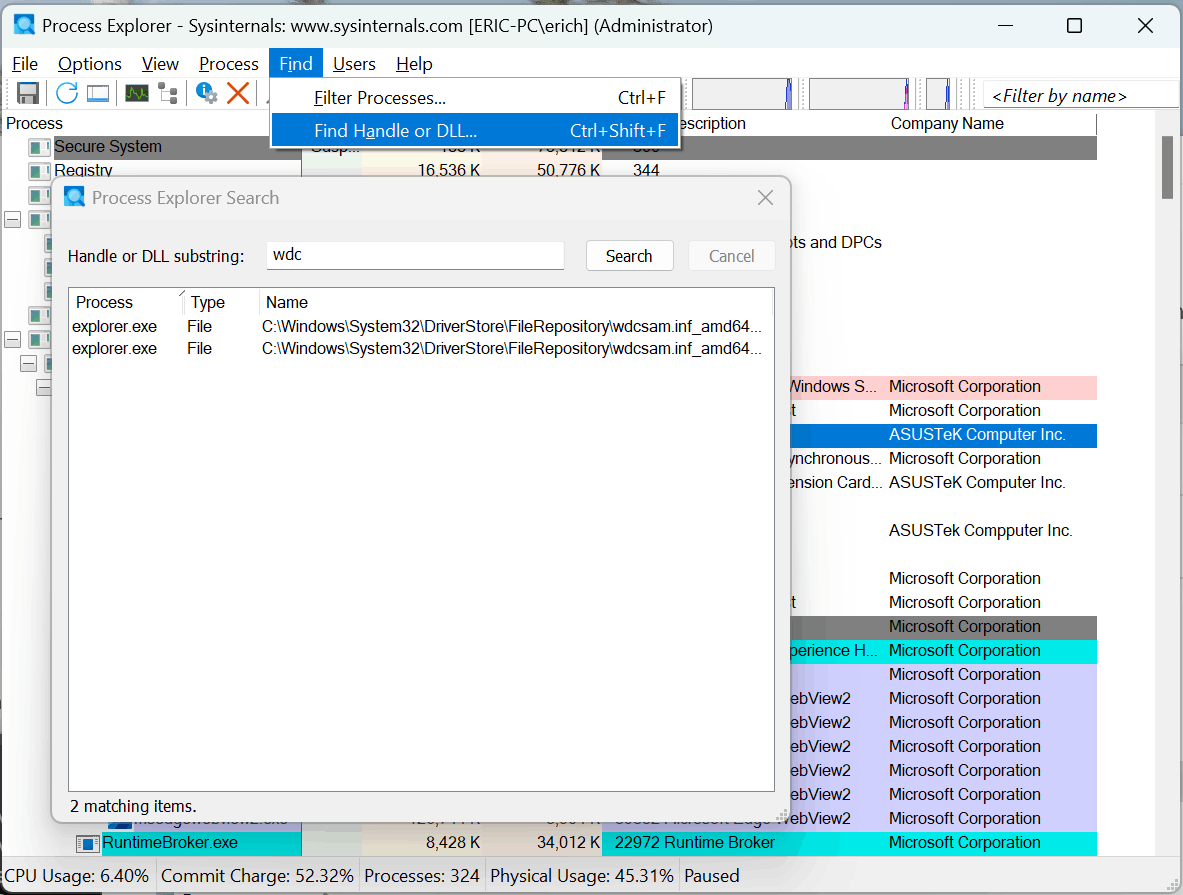

    You can download and extract Sysinternals Process Explorer, run it as Admin and then click Find > Find Handle or DLL and search for wdcsam.inf:
    Click on all instances of the wdcsam.inf driver as shown above, it will bring you to the process using this driver in the bottom window, and you can right-click > Close Handle for each one:
    Once they're closed, you can execute the pnputil /delete-driver oem##.inf command in an elevated Powershell successfully:
    You should now be able to turn on Memory Integrity
