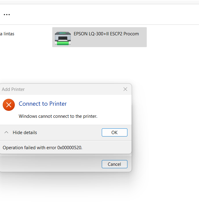

    2023-06-06T00:54:03+00:00
    Hi Ramesh ,
    I have 50 clients using windows 11 pro
    whom I support remotely
    All get the below error
    and I already tried below fix
    Is there anything else needs to be done
    This can happen to any printer
    The current client is Zdesigner Lp2844
