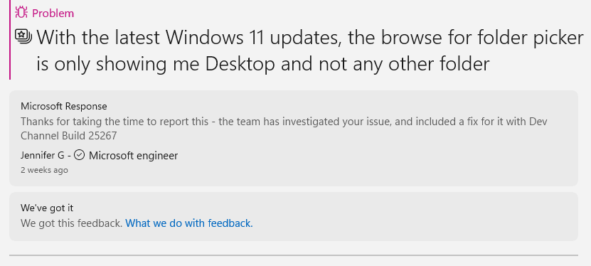

    2023-02-24T16:53:11+00:00
    Win11 feedback hub.
    Image:
    Text:
    Microsoft Response: Thanks for taking the time to report this - the team has investigated your issue, and included a fix for it with Dev Channel Build 25267
    Jennifer G - Microsoft engineer
