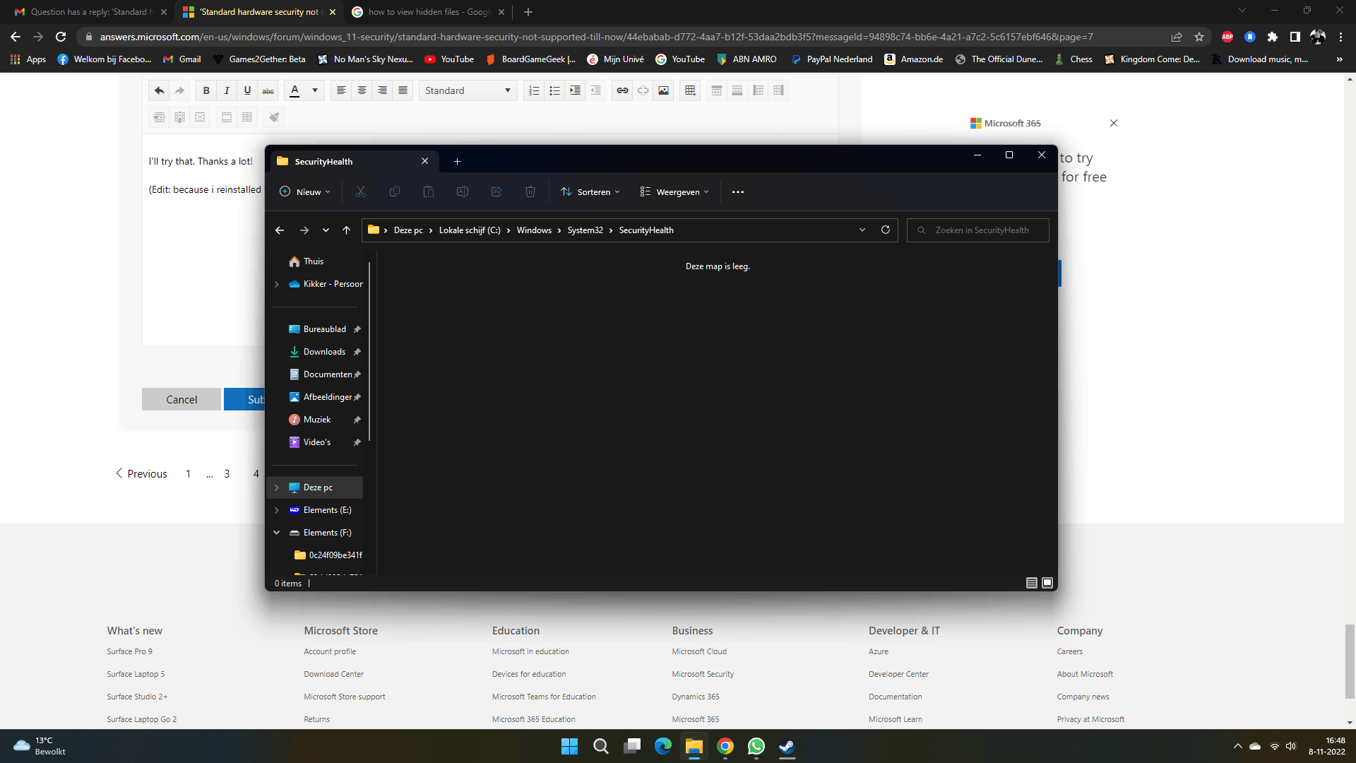

    2022-11-08T15:43:10+00:00
    I'll try that. Thanks a lot!
    (Edit: because i reinstalled win 11. The folder is empty)I did try what you said and i must congratulate you. You are the only person on the internet that completely resolved my issue. I salute you! And thank you so much.

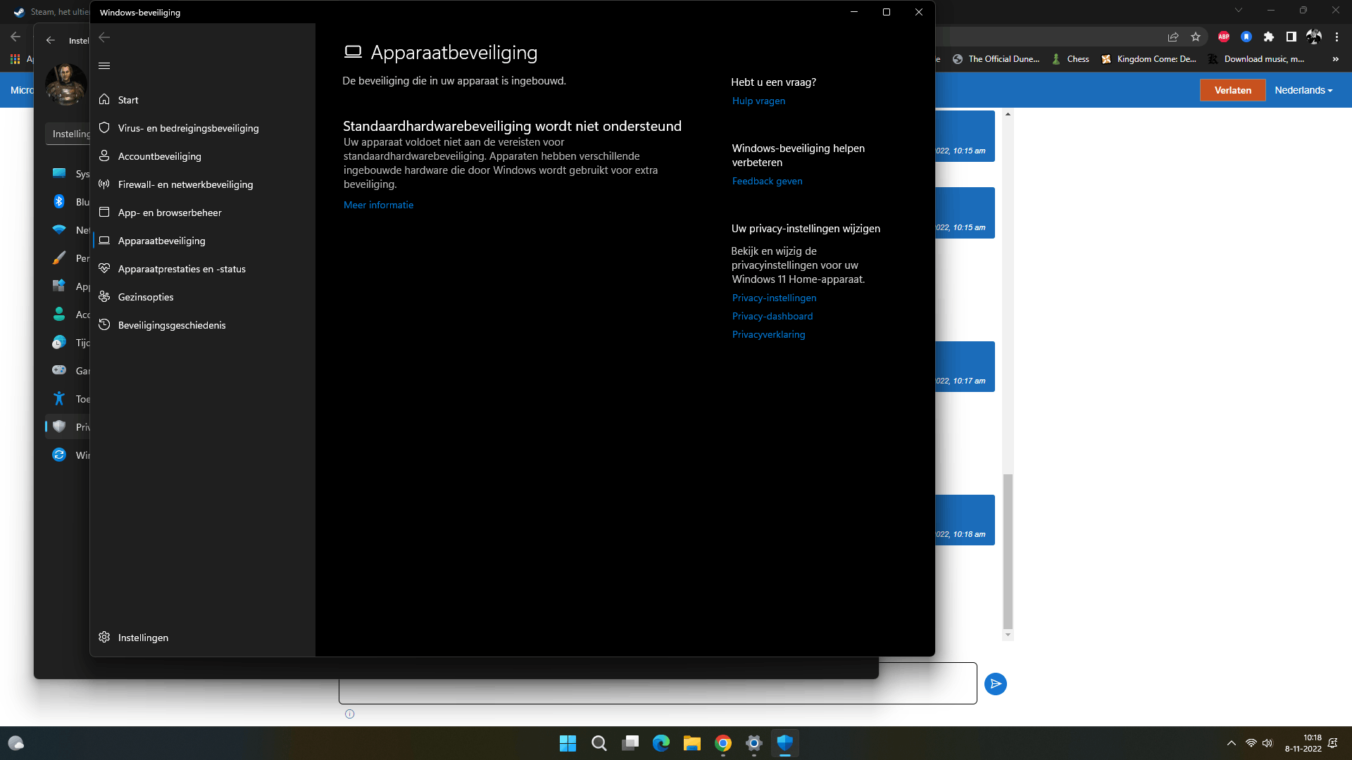

    2022-11-08T14:07:47+00:00
    Here is the screenshot. Normally, before the reinstall of windows 11, i could see the core isolation and Device security here.
    As i said under tpm.msc it says tpm 2.0 is enabled, also secure boot is enabled in systemcontrol.
