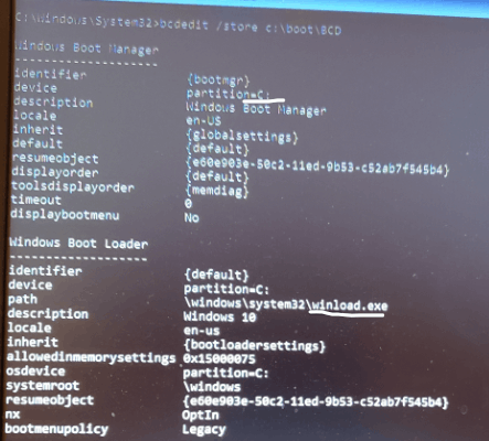

    That's incredible. Once again it looks like the process got to the brink -- all the way to the Windows boot manager -- before the failure. It didn't put up a boot menu because it's a single boot. But just as with the IBM manager, it should at this point be loading the OS. Does the BCD still look like this...?...
    BCDEdit <<<Show BCD
    BCDEdit /Store C:\Boot\BCD <<<Do If prior failed
    Instead of C:, it might refer to HarddriveVolume3. Then, do these find the files...?...
    DIR /a C:\BootMGR <<<Is BootMGR there?
    DIR /a C:\Windows\System32\Winload.exe <<<Is Winload.exe there?
    But use the letter that is in the BCD. And, maybe, with a List Vol, verify it actually is the letter that is on the Windows volume.
