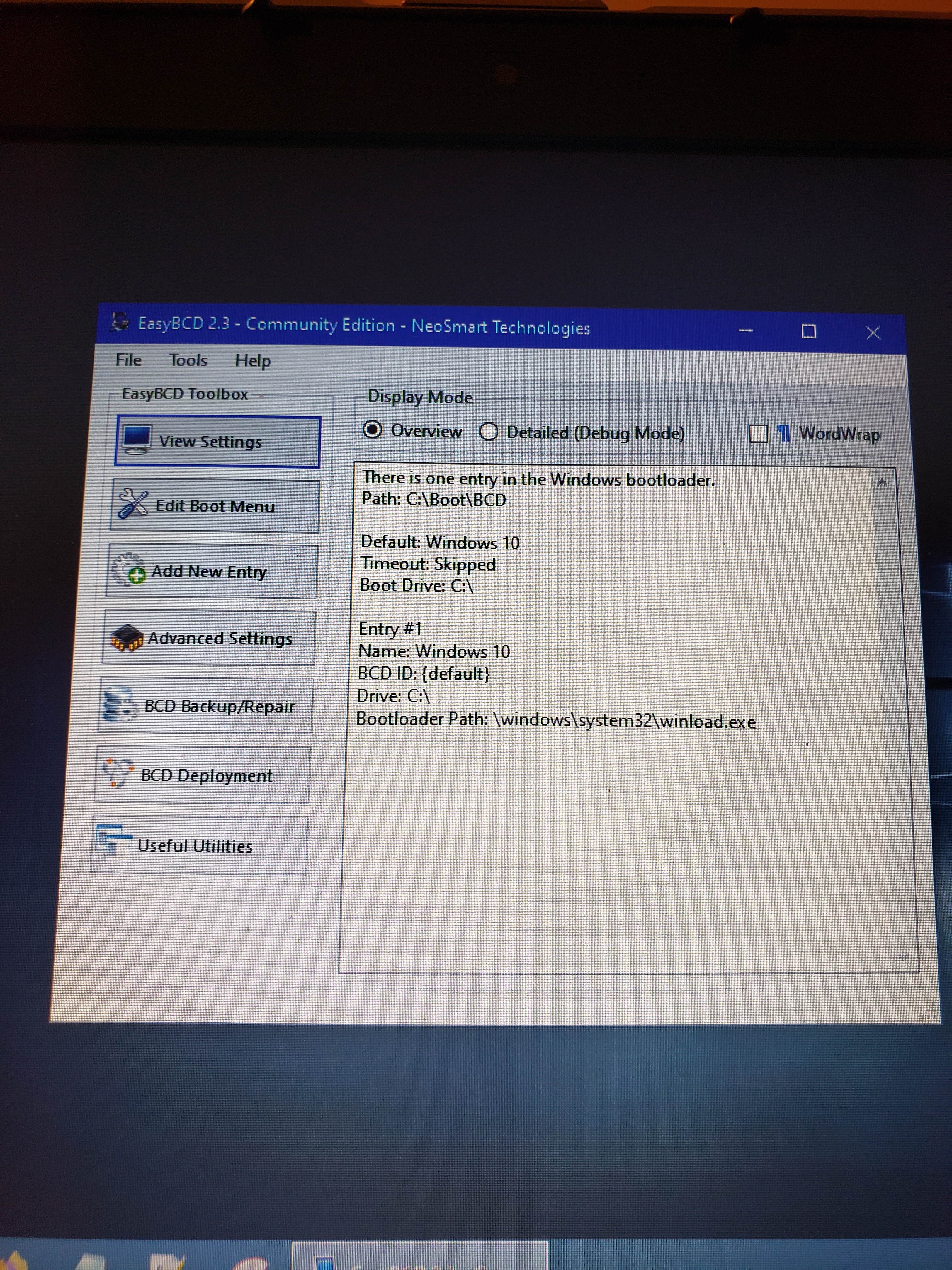

    /Store specifies where to look for the BCD. Without it, BCDEdit complained it couldn't find the "system device". It should show the location of bootmgr which should be C: (maybe referred to as HarddriveVolume3). Also, it should show C as the partition it will load. If that BCD were being used for the dual boot, it would also show a Boot Loader that identifies the eCS partition as D: (or maybe HarddiskVolume4). But EasyBCD shows it isn't a dual boot.

    (4) DFsee cannot see the BCD. I use EasyBCD on Hiren's CD (See post with pic)

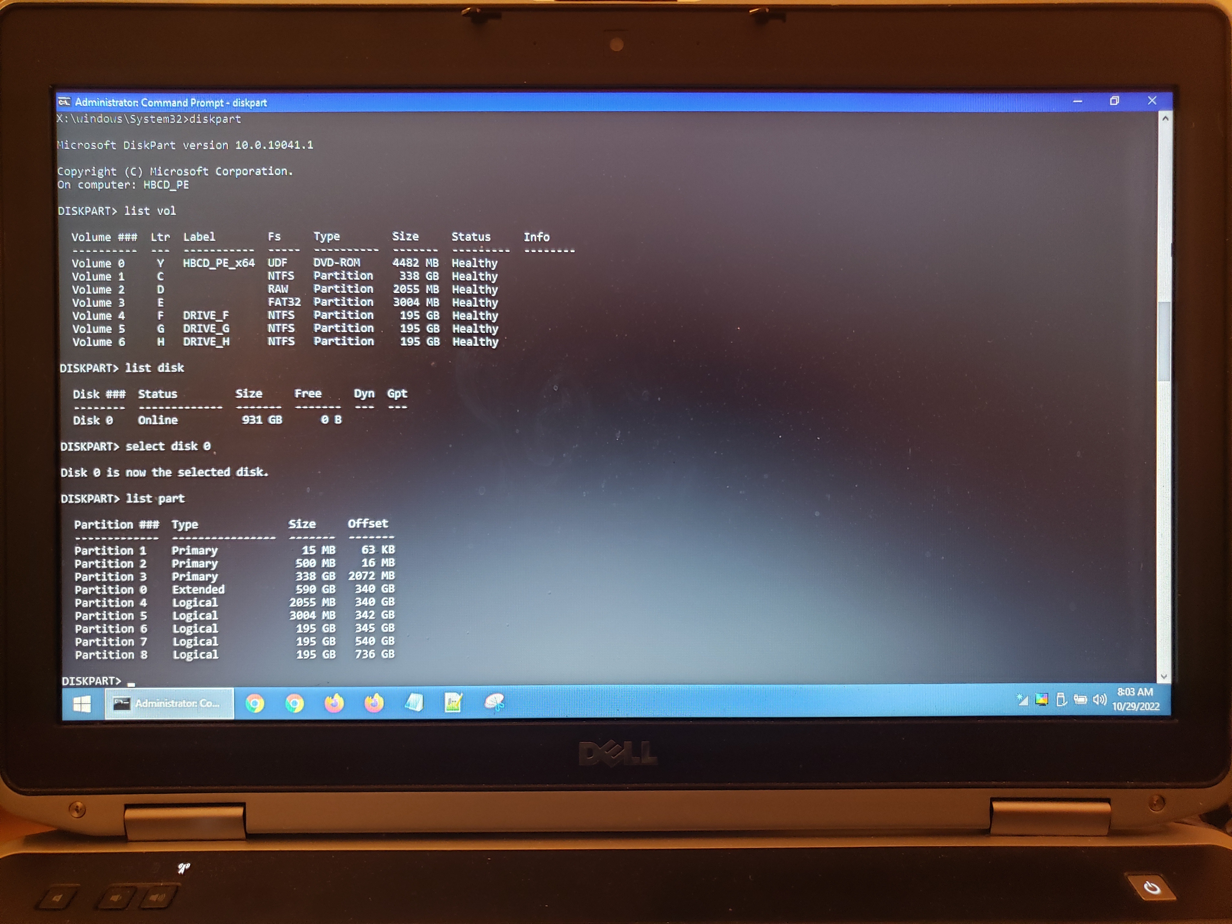

    Partition 1 is IBM BM
    Partition 2 is SR formatted NTFS
    Partition 3 is Win 10 formatted NTFS
    Partition 4 is eCS formatted HPFS
    Partitions 5 is a data partition formatted as FAT32
    Partitions 6,7,8, are data partitions formatted as NTFS
    Jordan

    I want to see the device/path to the partitions in the BCD & the order of the partitions on the disk...
    DiskPart
    List Vol
    List Disk
    Select Disk 0
    List Part <<<Shows the order of the partitions
    Exit
