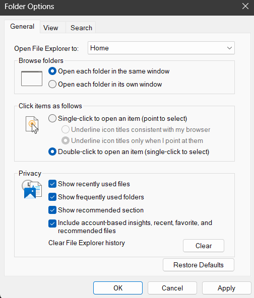

  2. 'Home' as startup-folder seems to also be slow, change it: https://www.digitalcitizen.life/how-set-start-location-file-explorer-windows-10/

    I don't have such an option:
