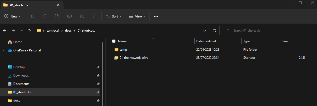

    My Explorer looks like this:
    1. I dont use any mapped Network-Drives / Shares and removed them all. Instead I use Shortcuts like '01_the network drive'. Somehow it seems, that Windows Explorer on startup tries to connect to all mapped Network-Drives, if some are not available (Network problems, VPN not connected) it hangs.
    2. I use pinned directories, like 'docs'. I try to keep all pinned directories pointing to local, meaning 'C:'. To go to my Network-Drives I click '01_shortcuts' which will lead me to the shortcuts stored locally on C:\somewhere
    3. I would love to disable 'Home' and try to not use it at all: Image
    4. I disabled OneDrive.exe in the Startup apps: Image
      Notice the upper right corner in my Explorer: there is no OneDrive-Sign. I can still use OneDrive, but I like to start it manually whenever i really need it. I try to work with my Network-Shares and other Cloud-Providers and am only using OneDrive where needed
    This seems to work pretty fine. Probably 4 times in a month the pinned-section (see picture above: Desktop, Downloads, Documents etc.) loads slowly probably 5 Seconds. And only 'This PC -> Local Disk (C:)' is showing. Therefore i also try to move my pinned directories to C:, so that i will find them easily if they are not loaded. Also 'Downloads' and 'Documents' sometimes has problems, i probably should replace even these pinned Directories with some links ;-).
