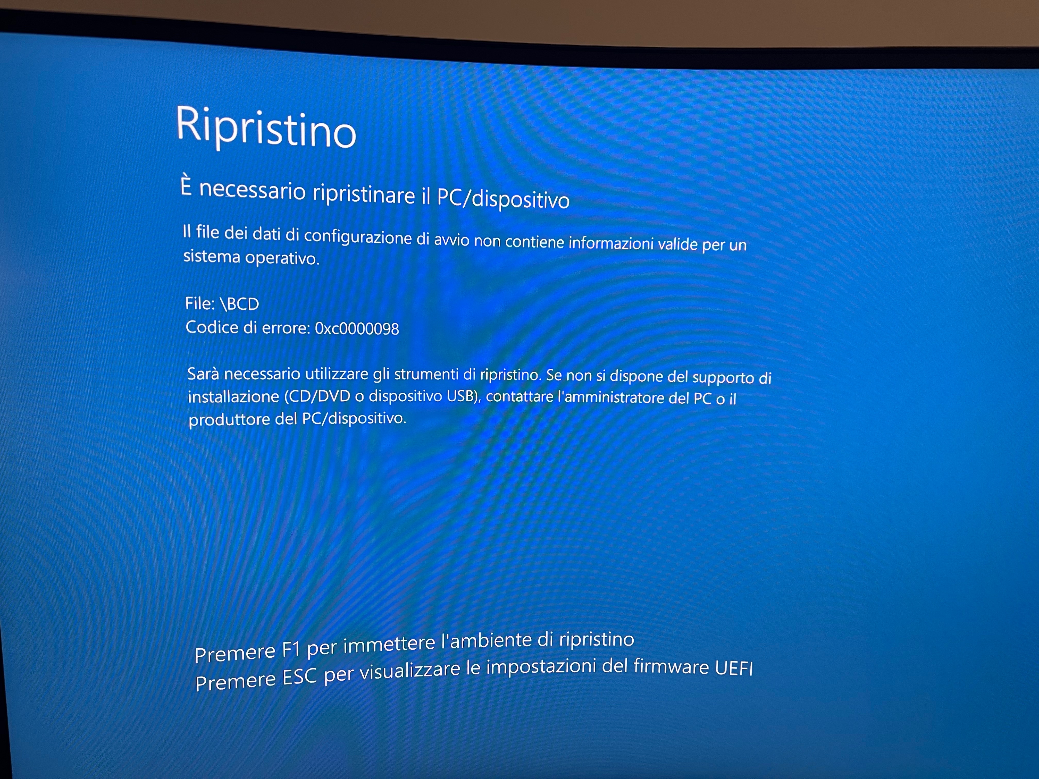

  1. Ramesh 181.6K Reputation points Volunteer Moderator
    2022-11-27T17:27:05+00:00
    Sacha,
    The BCD is corrupted. Please boot using the USB setup disk and get into the recovery options.
    Press Shift + F10 to open Command Prompt.
    Please run the commands and post the screenshot:
    diskpart
    lis disk
    lis vol
    2022-11-27T17:24:21+00:00
    It did update to 22h2 but after a restart it does not boot anymore
    If I go f1 and then “continue” the system loads though
