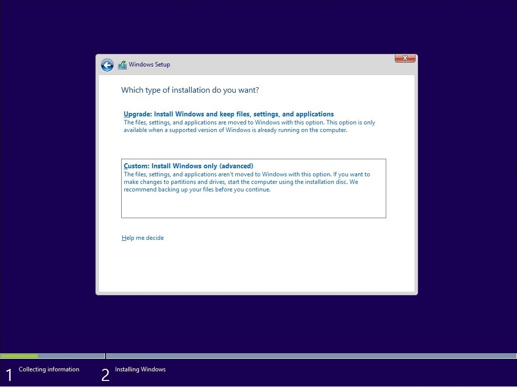

    2021-10-04T16:45:11+00:00
    Your data will not be deleted, so you can proceed.
    However, some apps may not work well, so you may need to reinstall them.
    Regards,

    Now I get two options after opening setup.exe:
    If I choose Upgrade, will all of my data and applications remain and not deleted?
