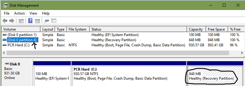

    It is the 627 MB partition appearing after C: in your Disk Management (DM). But it looks wrong in DM. It should look like mine...
    With or without a letter on my Recovery partition, I get that designation (disk 0 partition 4) in the top pane. And the bottom is as circled. Neither the letter nor the label I put on it (WinRE 21H1) show up in the bottom pane. (I'm sure they used to in prior versions.) They only show in DiskPart & File Explorer now. And here is what mine looks like in DiskPart...

    We want to get the letter off yours, but most important will be the Type code & possibly the Attrib. I suspect your Type code has gone bad & must be made to match mine. Hopefully, that will get your Disk Management to match mine. Then, we need to activate the Recovery partition either using ReagentC (which may not work) or by putting the code for it directly into the BCD.
