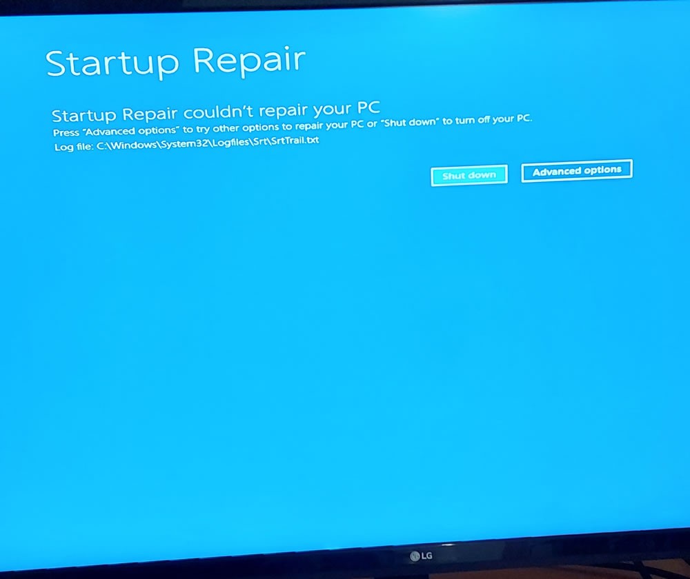

When booting up:
Prepare Automatic Repair - Diagnosing your PC
I see always
I have tried
1
Safe Mode, Uninstall the latest quality update, Restore back to point 18-10-2021 :
same symptom
2
Troubleshoot> Advanced options > Startup Repair:
same symptom

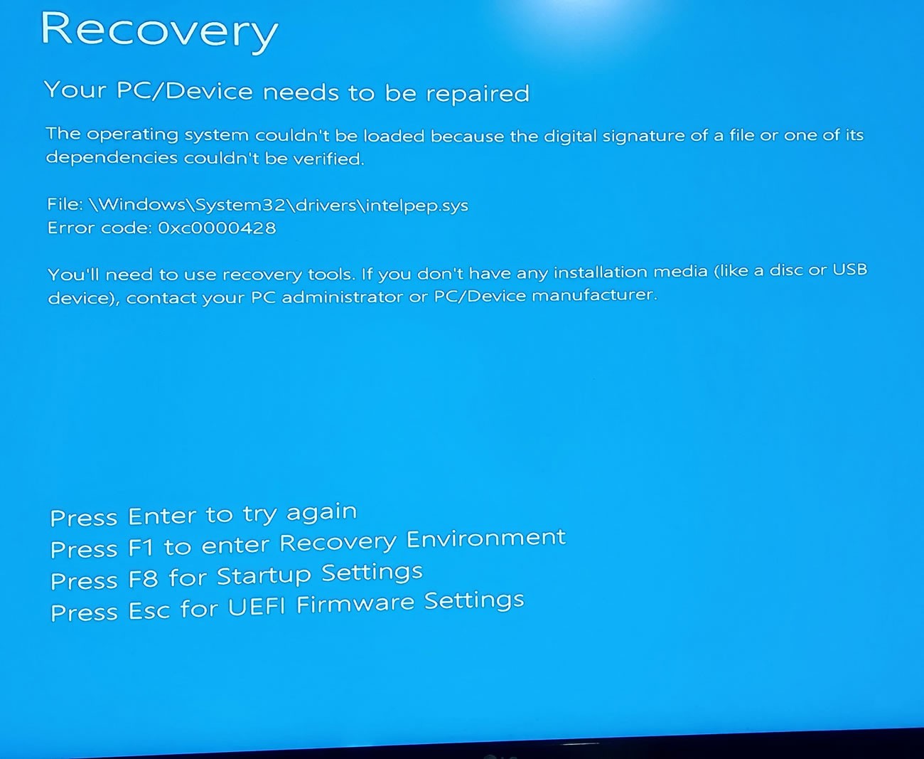

    2021-10-24T16:20:25+00:00
    I ran:
    BCDBoot C:\Windows
    I got a Success message
    but when went boot getting an error: // DVD boot from was 21H1 but OS is 20H2, is it matters? Following is the Log file,...well?
    when went to repair getting:
    Logfile:
    Startup Repair diagnosis and repair log
    Last successful boot time: ‎10/‎12/‎2021 6:25:29 AM (GMT)
    Number of repair attempts: 40
    Session details
    System Disk = \Device\Harddisk0
    Windows directory = C:\Windows

    Root cause found:
    A recently serviced boot binary is corrupt.
    Repair action: Abort pending update installations
    Result: Failed. Error code = 0x82f
    Time taken = 4109 ms
