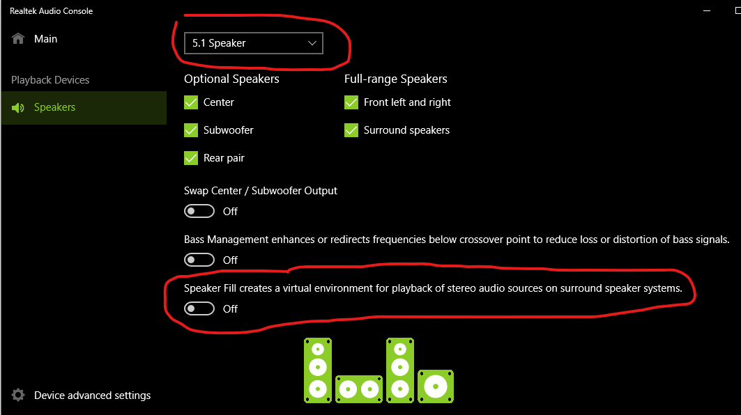

    in my case realtek audio console just states "Realtek Audio console doesn't support this device"

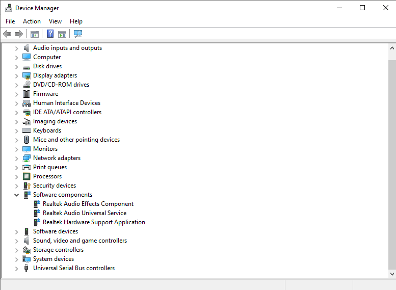

    Go to device manager and see if you have these 3 Realtek software components.
    If you don't have them, then re-install the realtek audio driver using the installer (often called setup.exe).

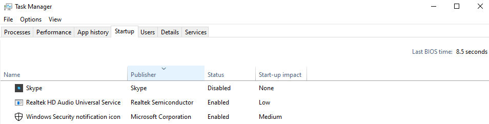

    If you have the 3 items, then go to task manager and make sure the Realtek HD universal audio service is enabled on start-up.
    2022-03-26T23:25:16+00:00
    I wanted to detail this post with a bit more information, just in case others need the same help. After the sound control panel is open, single click the speakers in the playback tab. Once that is done, click on the Configure button on the bottom, configure your speakers for whatever you are using, test, click next and customize you configuration if need be. Then click next, next and finish and that is all.
