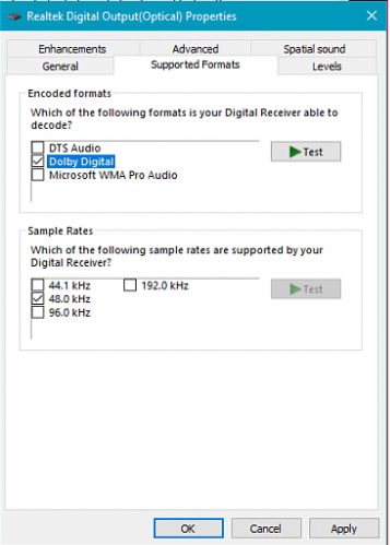

    2022-02-18T14:43:17+00:00
    This might be right if the option to configure wasn't disabled for the Realtek Optical Output. Clicking on Properties instead, and going to the Supported Formats tab, I can select and test both Dolby and DTS. Both work.
    My suspicion is that Dolby, DTS and MS worked out some kind of deal to try and prod people into using Atmos and DTS:X Ultra
