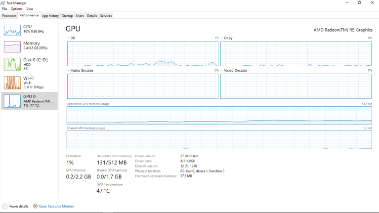

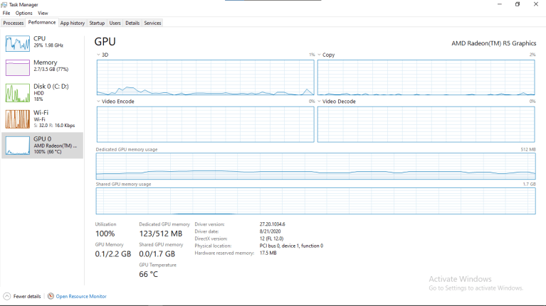

    2021-06-11T13:30:38+00:00
    So I switched off my laptop, opened the case and removed both the rams. I then kept the first ram (farthest from the screen. But when I switched on my laptop it did not open, the white light was there but screen was black, tried removing and keeping it back but didn't do anything. Then I kept the second one (closest to the screen) and it opened just fine. This is the GPU when the second ram is only used.
    This is the GPU when both rams are used
    Also, my numpad doesn't work now for some reason. Ones above the letters do, but the separate numpad does not.
    2021-06-11T11:13:06+00:00
    Thank you so much. Look at Shared GPU memory. It has 1.7 GB. This memory is took from the total RAM. You need to verify your bios settings about video configuration. I suggest you to reset your bios configuration to their default values.
