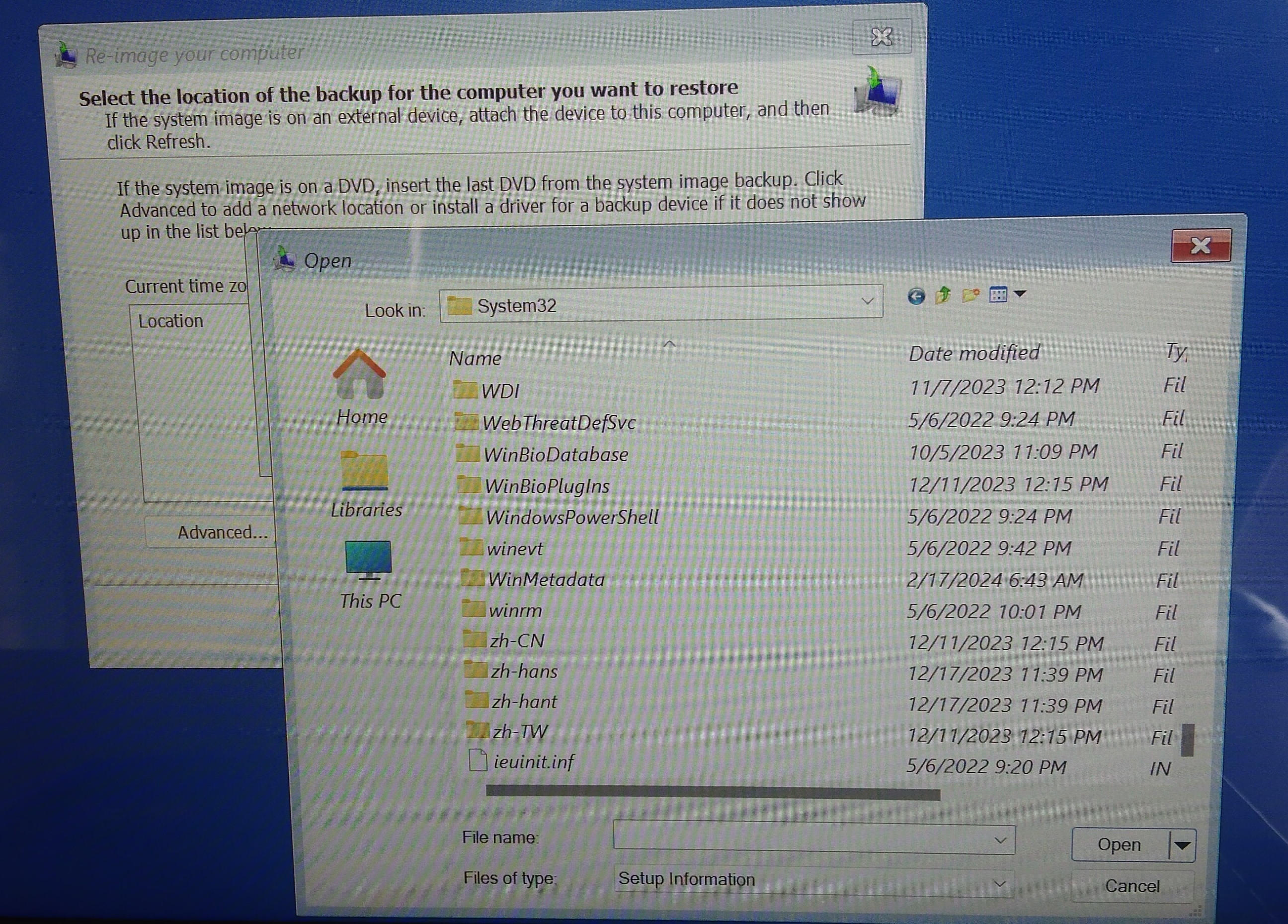

  7. Click Advanced, then select Install a Driver and click OK. This gets you access to a Windows Explorer-type folder structure.

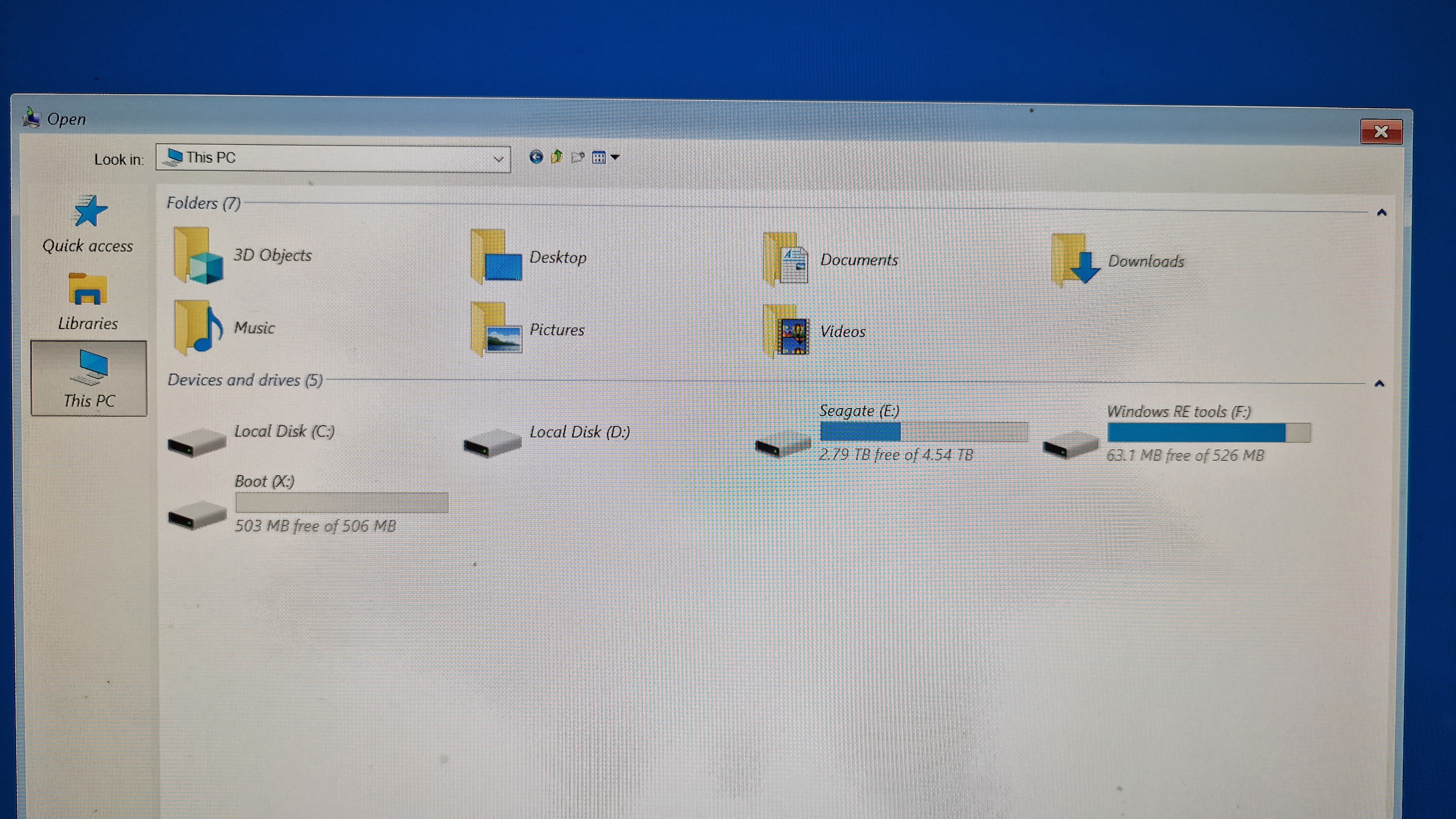

  8. Click This PC on the left side and find which drive has utilman.exe in the [drive letter]\Windows\System32 folder. The drive letter may not match your normal letters - this doesn't matter. Only one drive will have utilman.exe so you know you are in the correct one once you find it (my letters happened to match, except I had an X drive that wasn't useful).
  9. Rename Utilman to Utilman1. In this folder mode, you'll need to right-click and select Refresh to see the changes.

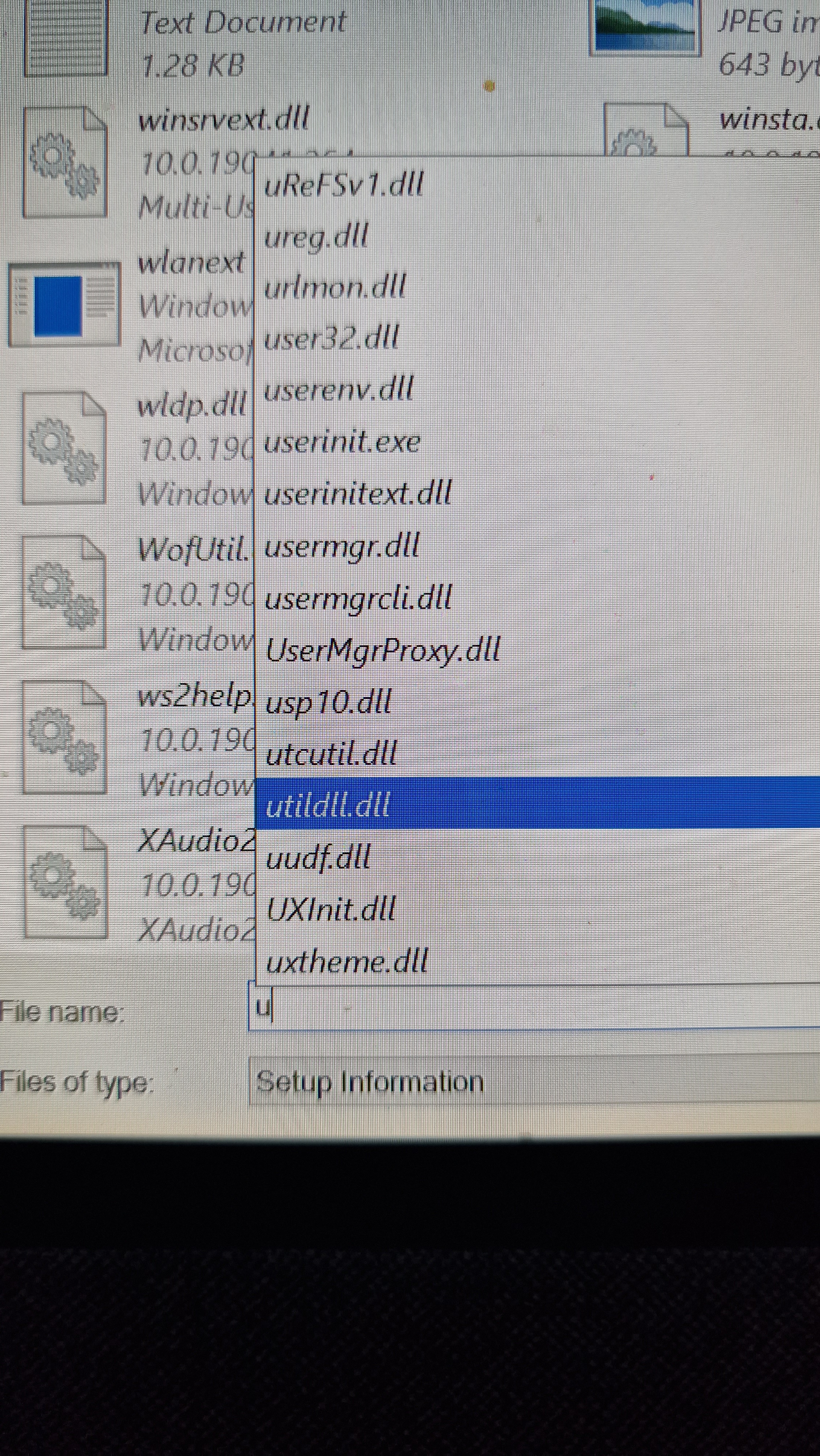

    Not able to find Utilman.exe in C:/Windows/System32
    in System32 in which folder I can find Utilman.exe ??

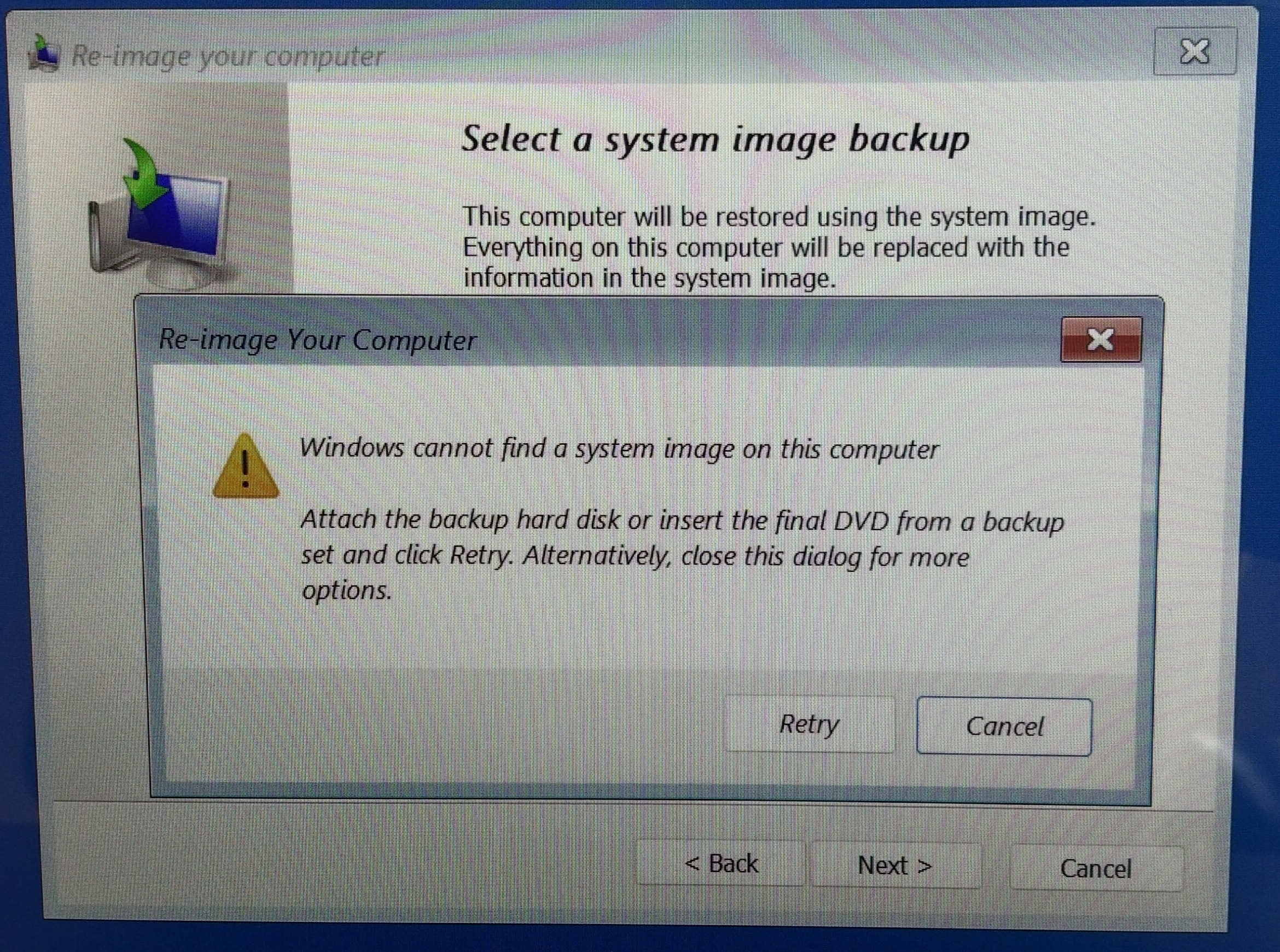

    2024-02-23T05:00:51+00:00
    I got this error after clicking on system image recovery.
    What to do now?
    Can any one help me out?

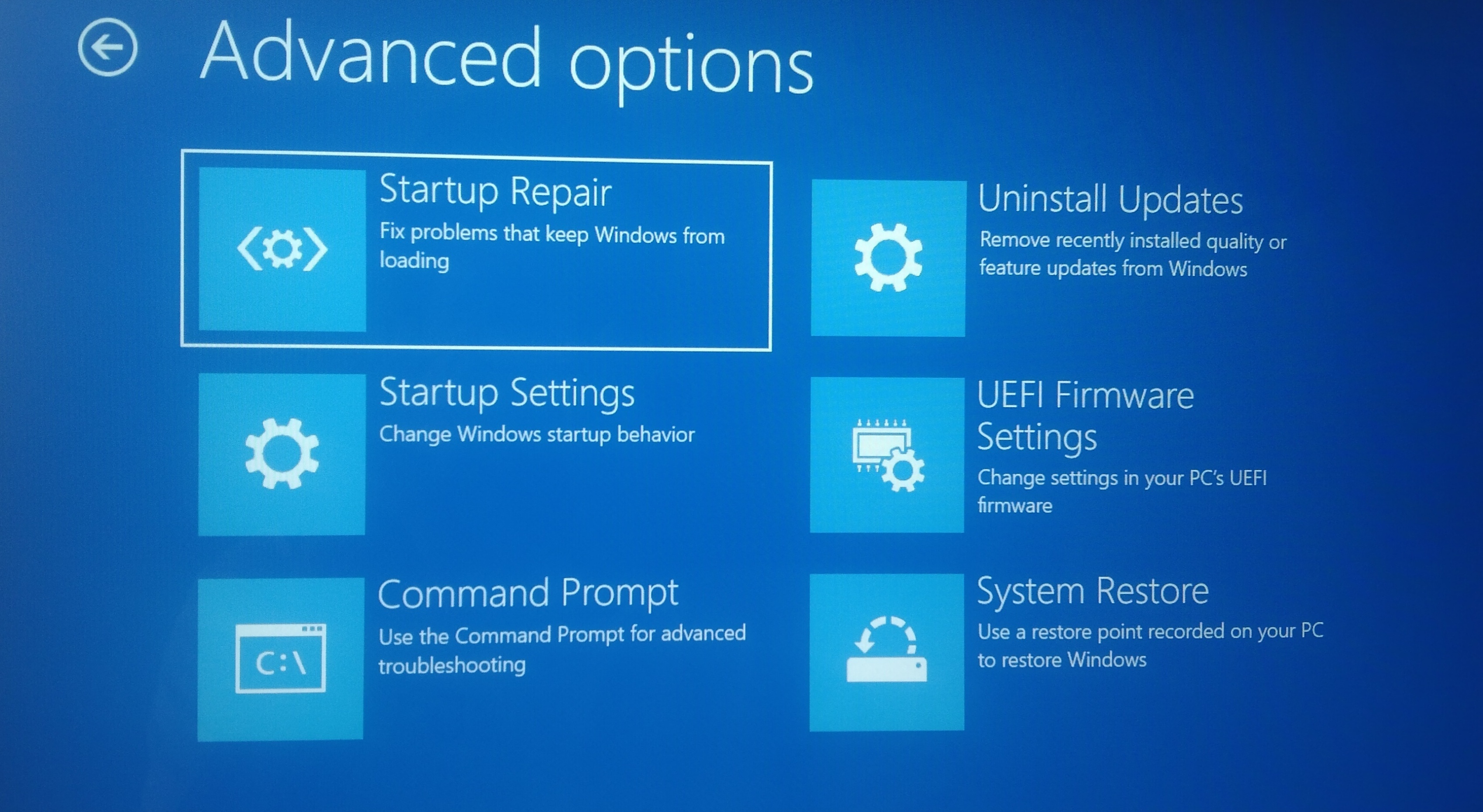

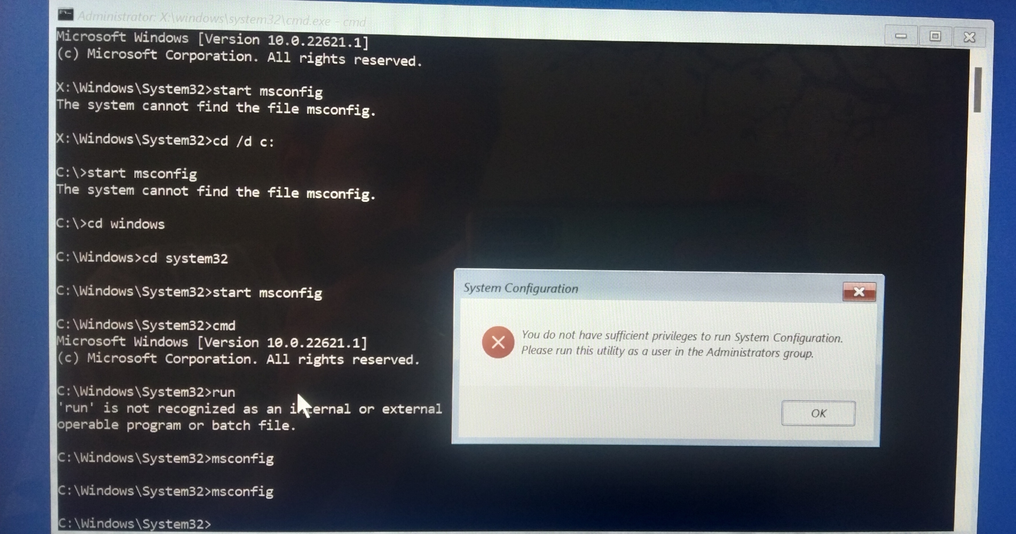

    2024-02-23T03:16:04+00:00
    I was stuck in diagnostic startup mode. So this will not work as all other background processes of windows get stopped in diagnostic startup mode and not able to sign in to my system as pin system is not running. All I have this advance recovery options as in image.
    Currently I was stuck in Diagnostic startup mode. All I have to do is I have to access system configuration(msconfig) and change startup option from diagnostic to normal mode. But any how I am not able open msconfig. It shows following errors. I have used command prompt option from advance options screen n try to open msconfig, but it shows following error..

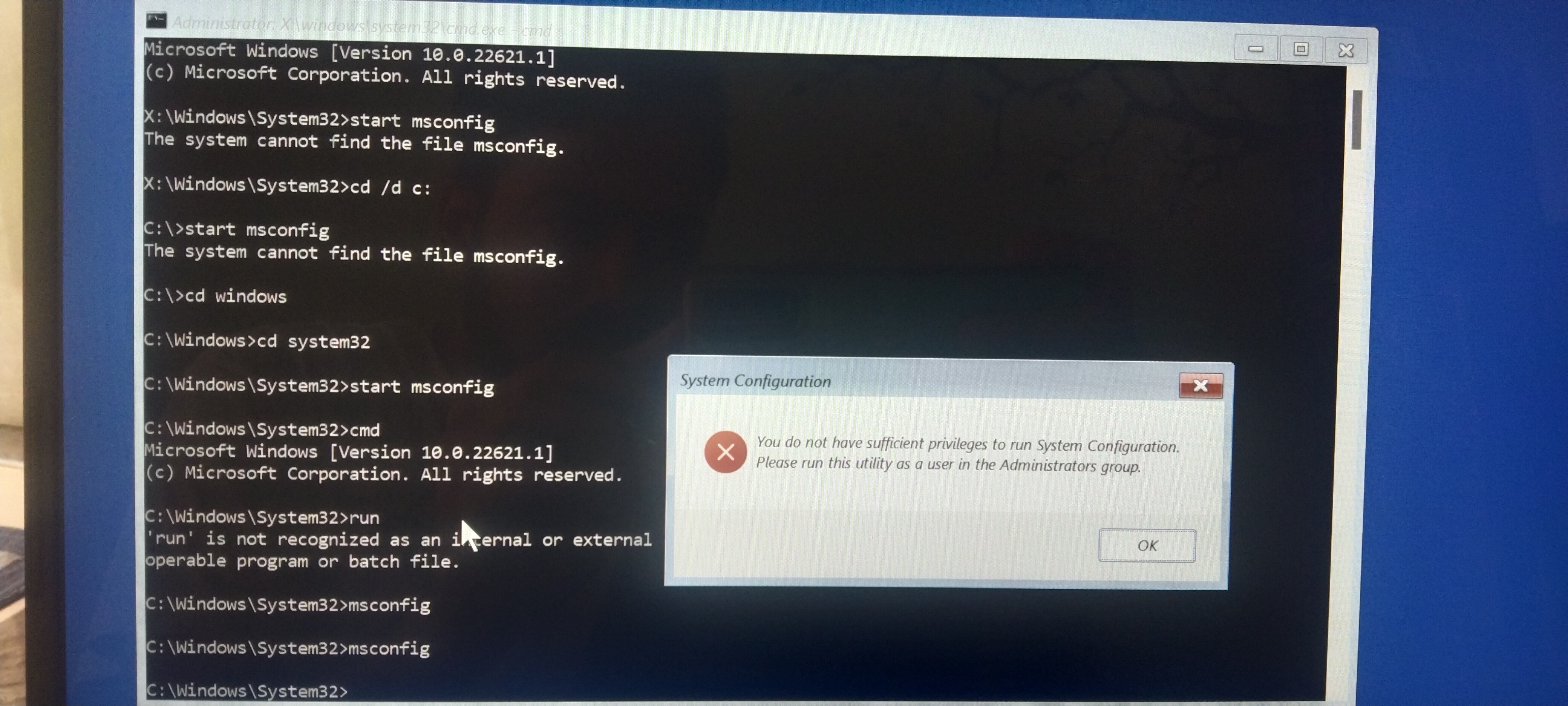

    2024-02-23T02:43:03+00:00
    I am stuck at the same place as you were..
    Able to open command prompt from advance options, but when I tried to start msconfig from command prompt it shows "You do not have sufficient privileges to run system configuration. Please run this utility as a user in Administrator group".
