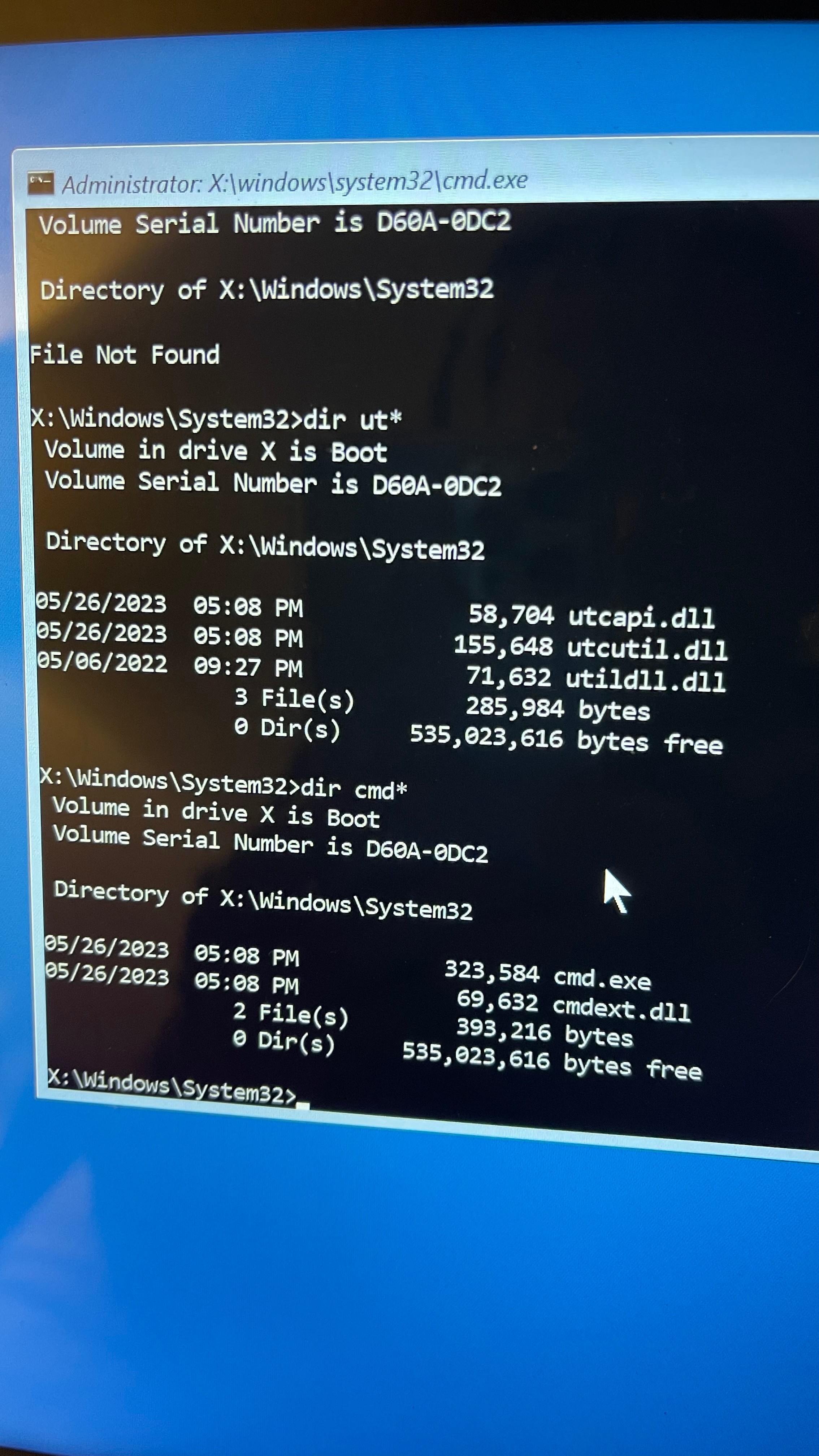

    2024-06-05T09:12:04+00:00
    Here are some things to check.
    =>The file may not have the extension and show up as "Utilman" instead of "Utilman.exe".
    =>You don't give much info about how far you got with the process. If you have gotten to the System32 folder, the Utilman file should be there.
    =>You have to scroll way, way down, past all the folders into the (alphabetical) list of files. Then keep scrolling until you see files starting with "U". Look closely. I had trouble finding it the first time.
    =>Also make sure you have gotten to the right Explorer/Windows/System32 folder from the System Image Recovery button (on the blue system repair window).
    =>Do you feel comfortable that you have followed the instructions or is there some confusion? More detail could help. Are you running Windows 10 or Windows 11?
    Let us know if this helps or send details and I will try to respond again.
    The WizardGrimm
    There is no ultimate.exe though. Here is windows 11 pro version screen shot from cmd window:
