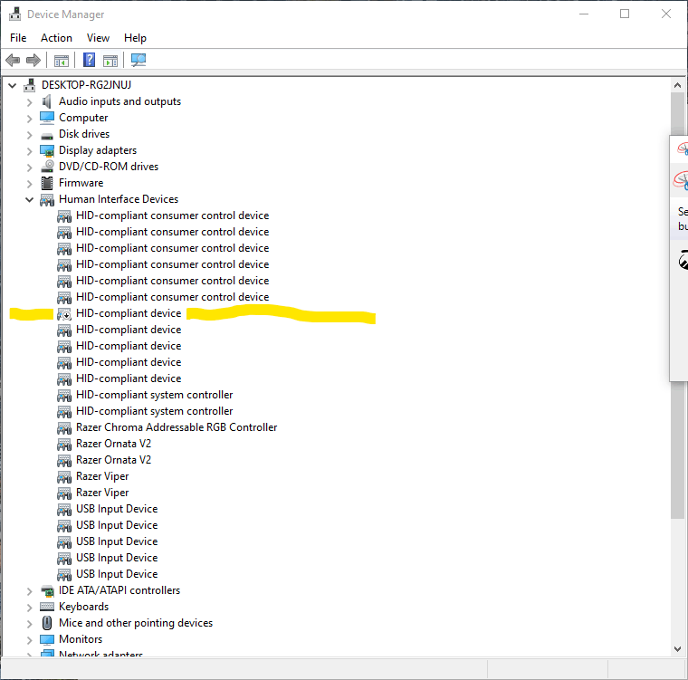

    There is a work-around. Disable HID interfaces. One of them should be causing it.
    Under "Human Interface Devices" in Device Manager, there are dozens of entries with different labels.
    • "HID-compliant consumer control device", 8 times
    • "HID-compliant device", 5 times
    • "HID-compliant system controller", x2
    • "USB Input Device", x5
    • "Razer Ornata V2", x2
    • "Razer Viper", x2
    • "Razer Chroma Addressable RGB Controller", x1
    Any idea which entries need to be disabled?
    Of the many HID-compliant devices, only one needed to be disabled.
    Device: HID\VID_1532&PID_025D&MI_03&Col01\7&2b0d549b&0&0000 was configured.
    Driver Name: input.inf
    Class Guid: {745a17a0-74d3-11d0-b6fe-00a0c90f57da}
    Driver Date: 06/21/2006
    Driver Version: 10.0.19041.868
    Driver Provider: Microsoft
    Driver Section: HID_Raw_Inst.NT
    Driver Rank: 0xFF1004
    Matching Device Id: HID_DEVICE
    Outranked Drivers:
    Device Updated: false
    Parent Device: USB\VID_1532&PID_025D&MI_03\6&18958d27&0&0003
    Vendor ID: 1532 (Razer), Product ID: 025D (Ornata V2 keyboard)
    2021-04-05T10:36:15+00:00
    Thanks!
    To save viewing, it says to go into Device Manager and disable all the 'HID compliant' devices.
    Indeed, I did this, everything still works, and it's stopped the issue for me.  It's a valid workaround.
    I suggest:
    log-in.
    show the HID compliant' selection in Device Manager
    Unplug all usb devices except the device causing the issue.  This will cause unrelated HID devices to be hidden from view.
    Disable the remaining HID devices (if only keyboard is connected, use keyboard shortcuts: tab, cursor arrows etc)
    Plug your devices back in, test to check your workaround is a success.
