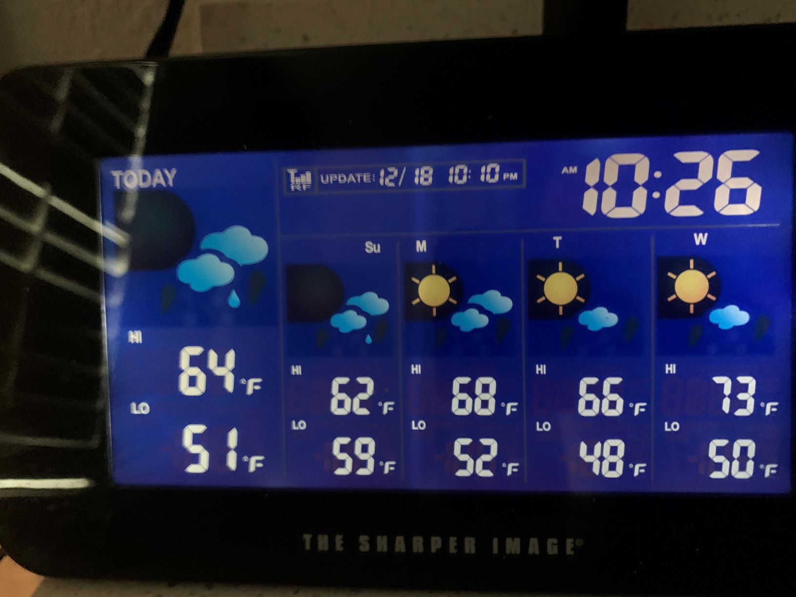

    2020-12-19T15:39:08+00:00
    Two years ago, someone named Jack had a solution, for the tech savvy.   But the forum he offered it in - https://michaldemin.wordpress.com/2015/04/12/4-day-forecast/ does not let me subscribe in order to contact him.  He had a modified "getweather.php" he was offering to email to people.
    Mitch156 I was able to use the current version posted at: https://github.com/robots/4dayforecast/ the only change I made was to edit the getweather.php to add my own weatherbit.io account key.  Other than that, it worked right out of the "box."  Assuming you run a webserver and modify your hosts file.
    2020-12-19T12:06:29+00:00
    I think the end has come.  I've decided to wait until Jan 1 and then unplug forever.  Rather sad, since I really like this unit for the past 10+ years.
