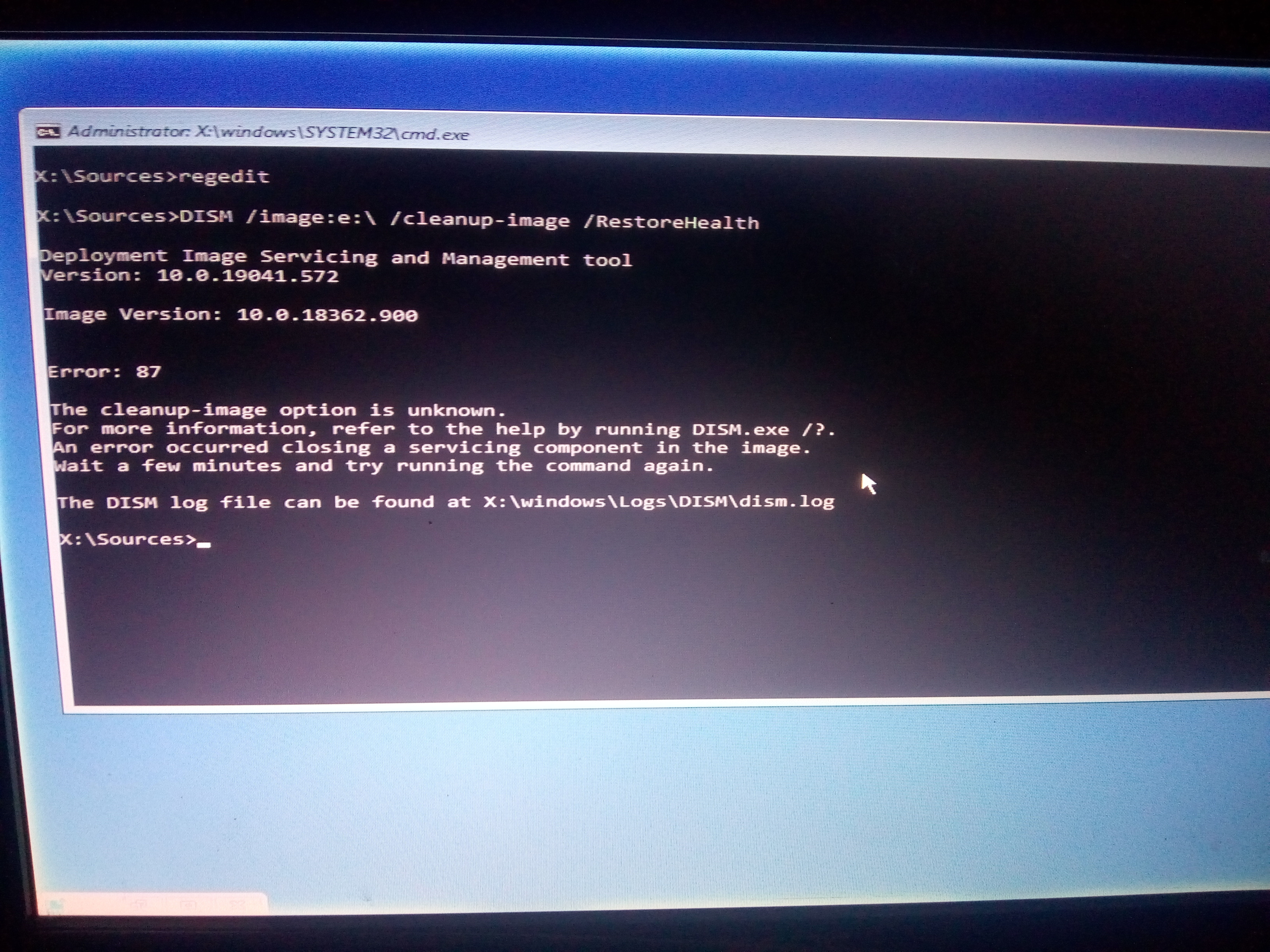

    2021-02-10T20:08:16+00:00
    Ok. Cleanup-image is still not working.
    Can you post the automatic repair log?
    E:\windows\system32\logfiles\srt\srttrail.txt

    2021-02-10T19:11:39+00:00

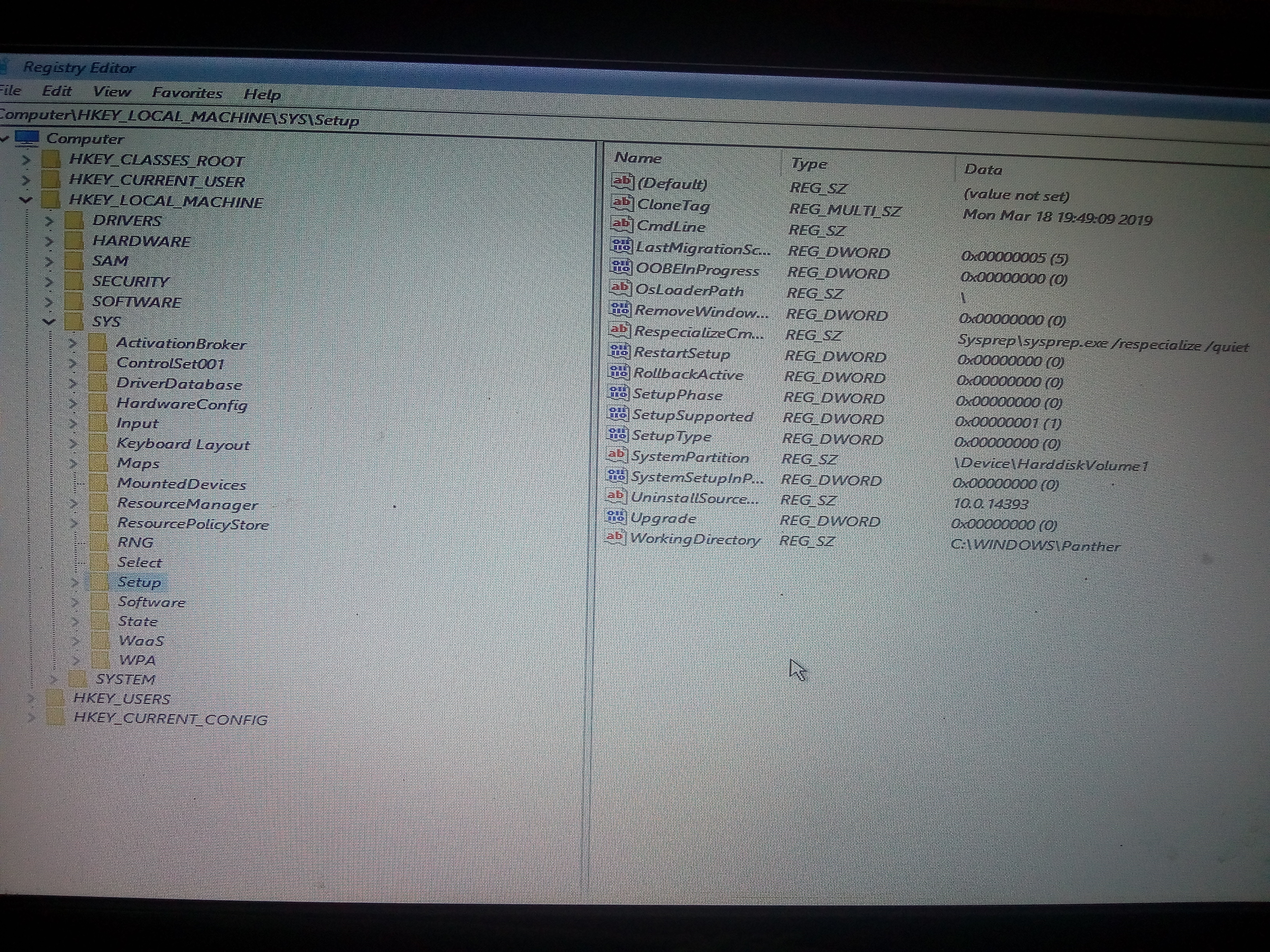

    2021-02-10T18:28:57+00:00
    Can you Select HKEY_LOCAL_MACHINE\SYS\Setup
    So we can see the values? I'm interested in
    setupphase
    setuptype
    systemsetupinprogress
    Also does the /cleanup-image work now?
    dism /image:e:\ /cleanup-image /restorehealth
    AamazingTech2
    Sir, this is my SYS setup values ImageAnd sir ,i tried with DISM command its same issue with unknown but a new line is coming which says An error occurred closing a servicing Component in the image. Image
