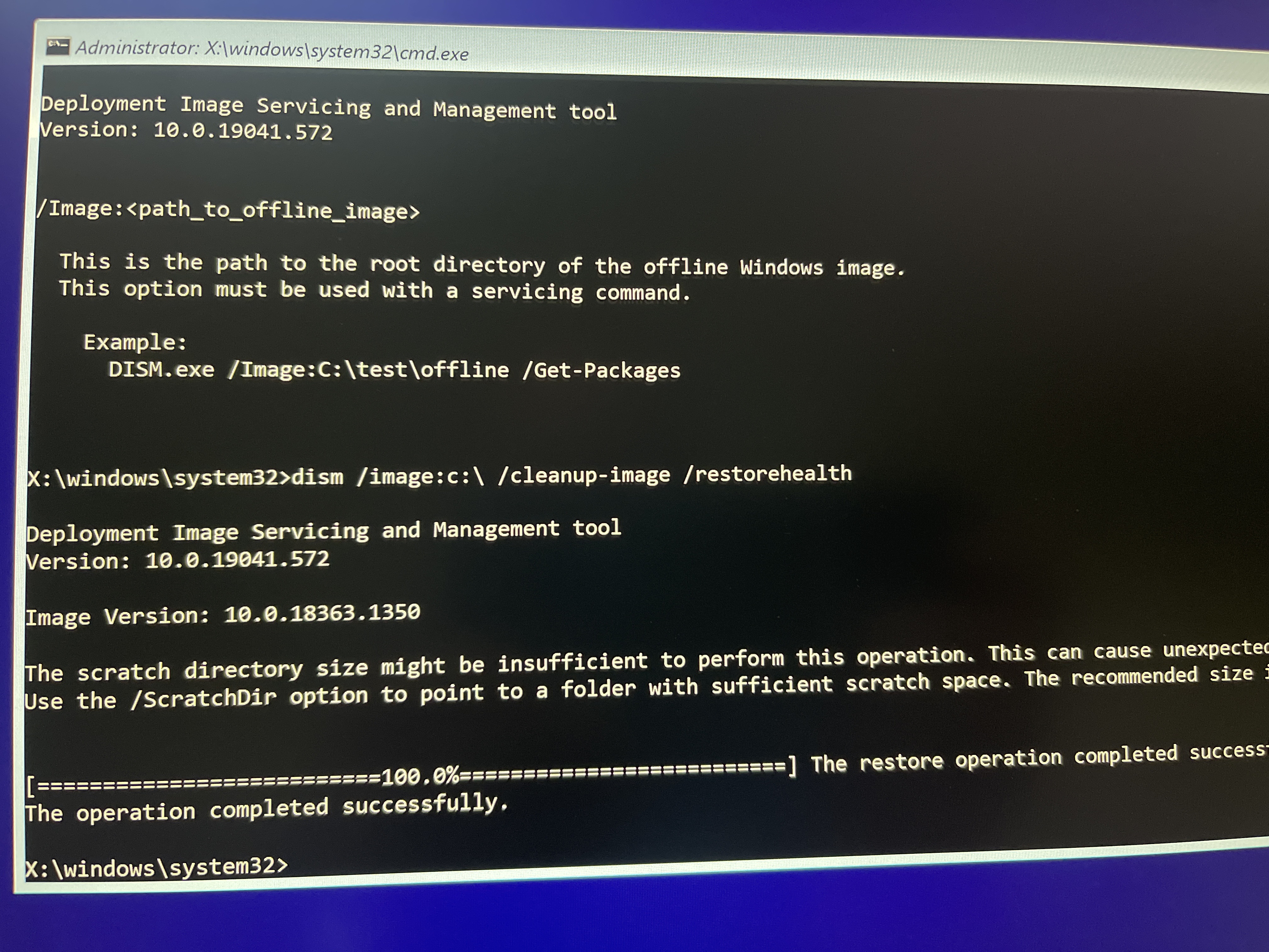

    My 1903 image (10.0.18362.30) worked with the /cleanup-image

    ![](https://learn-attachment.microsoft.com/api/attachments/058db81a-e7d8-4e4a-a2df-5f0ec7d2eb91?platform=QnA
    i just tried on my 1909
    I’ll try imaging 1903 like yours and try the command.

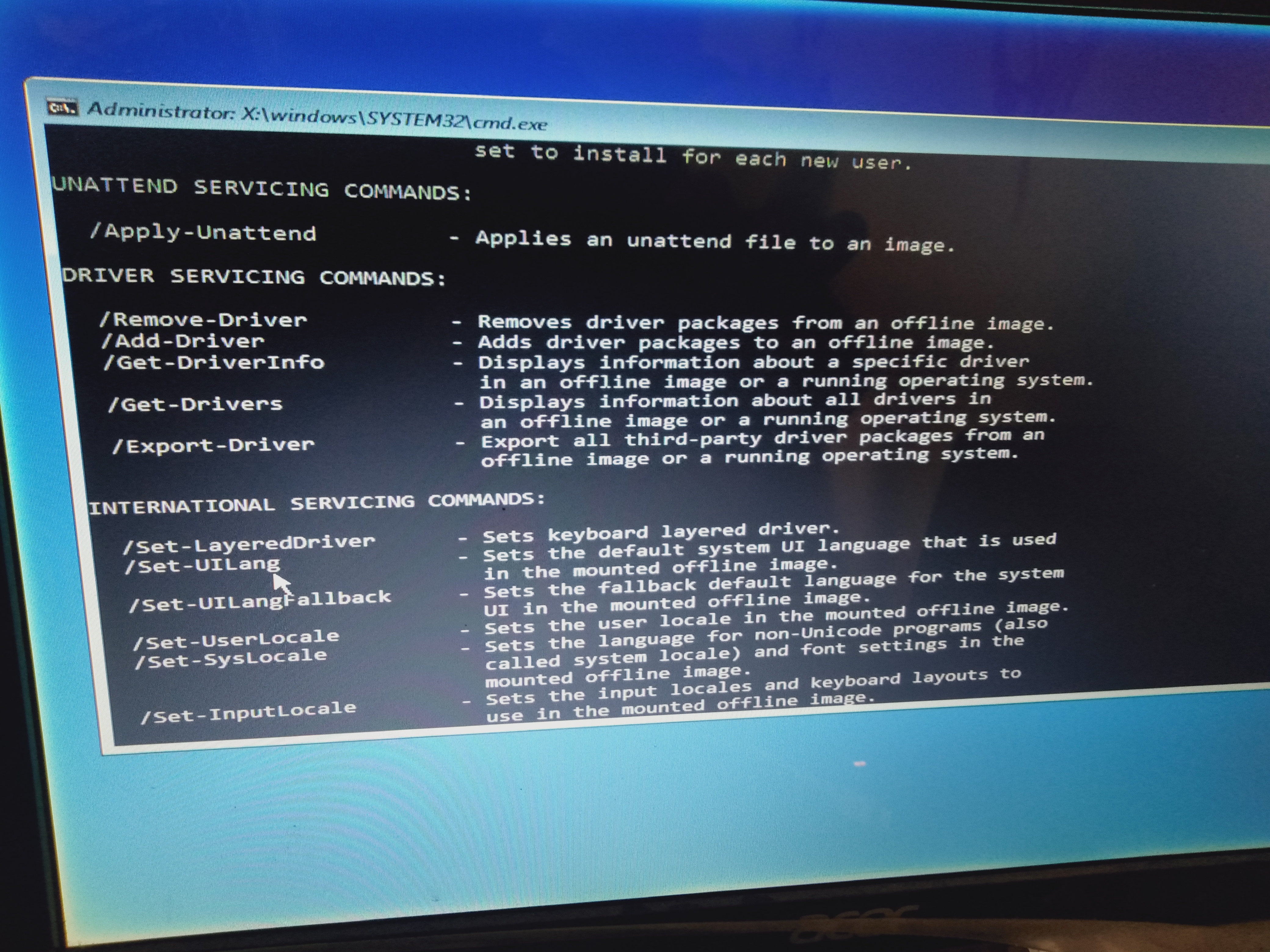

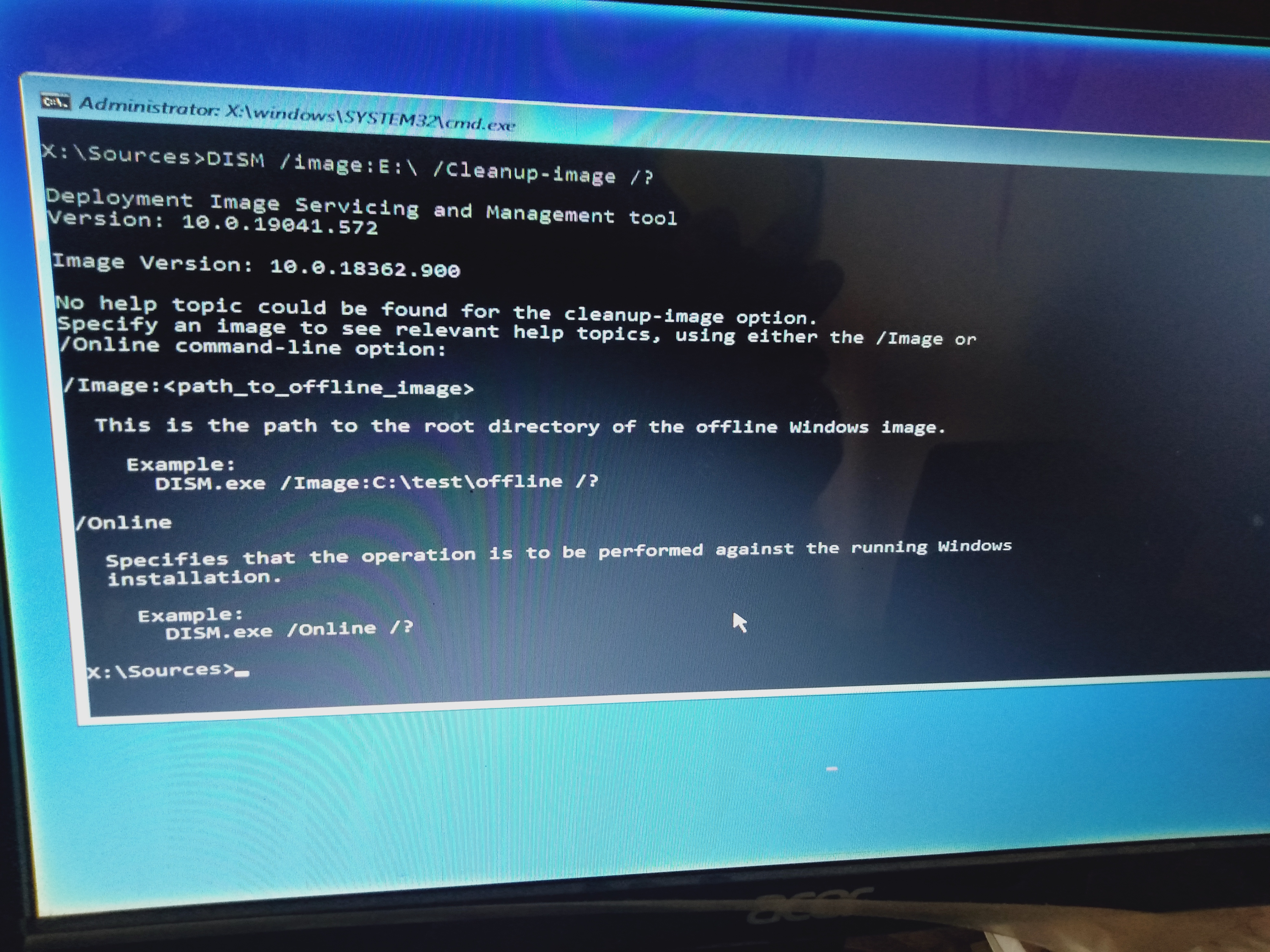

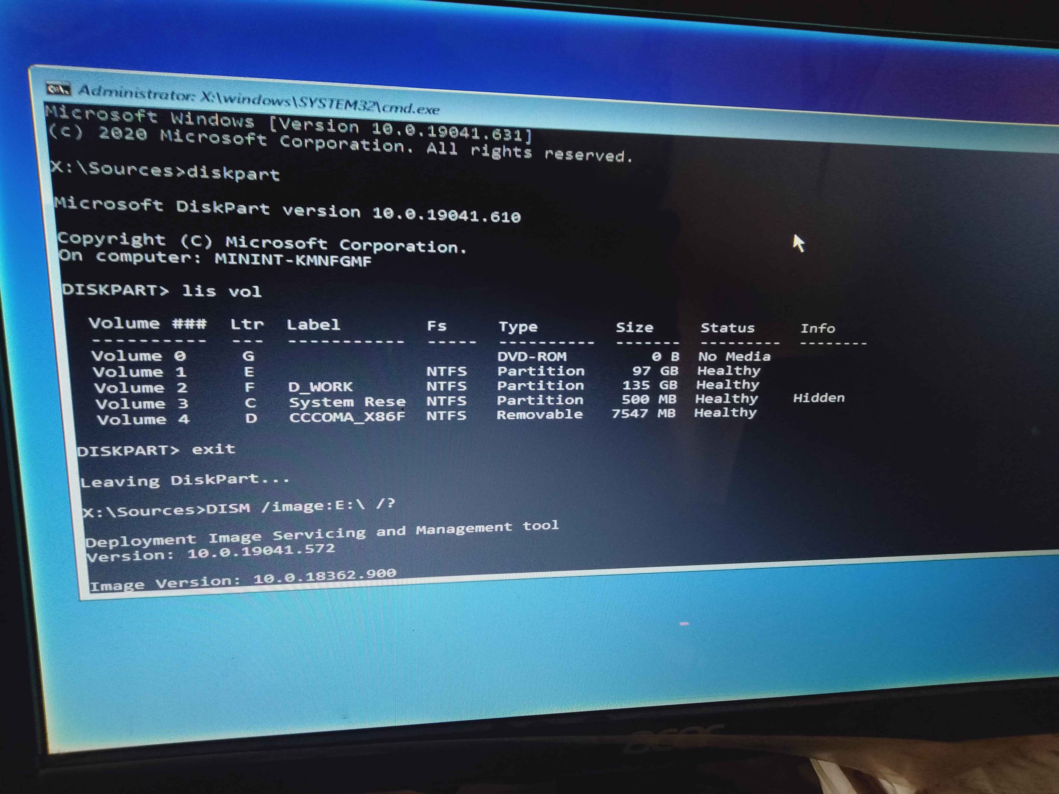

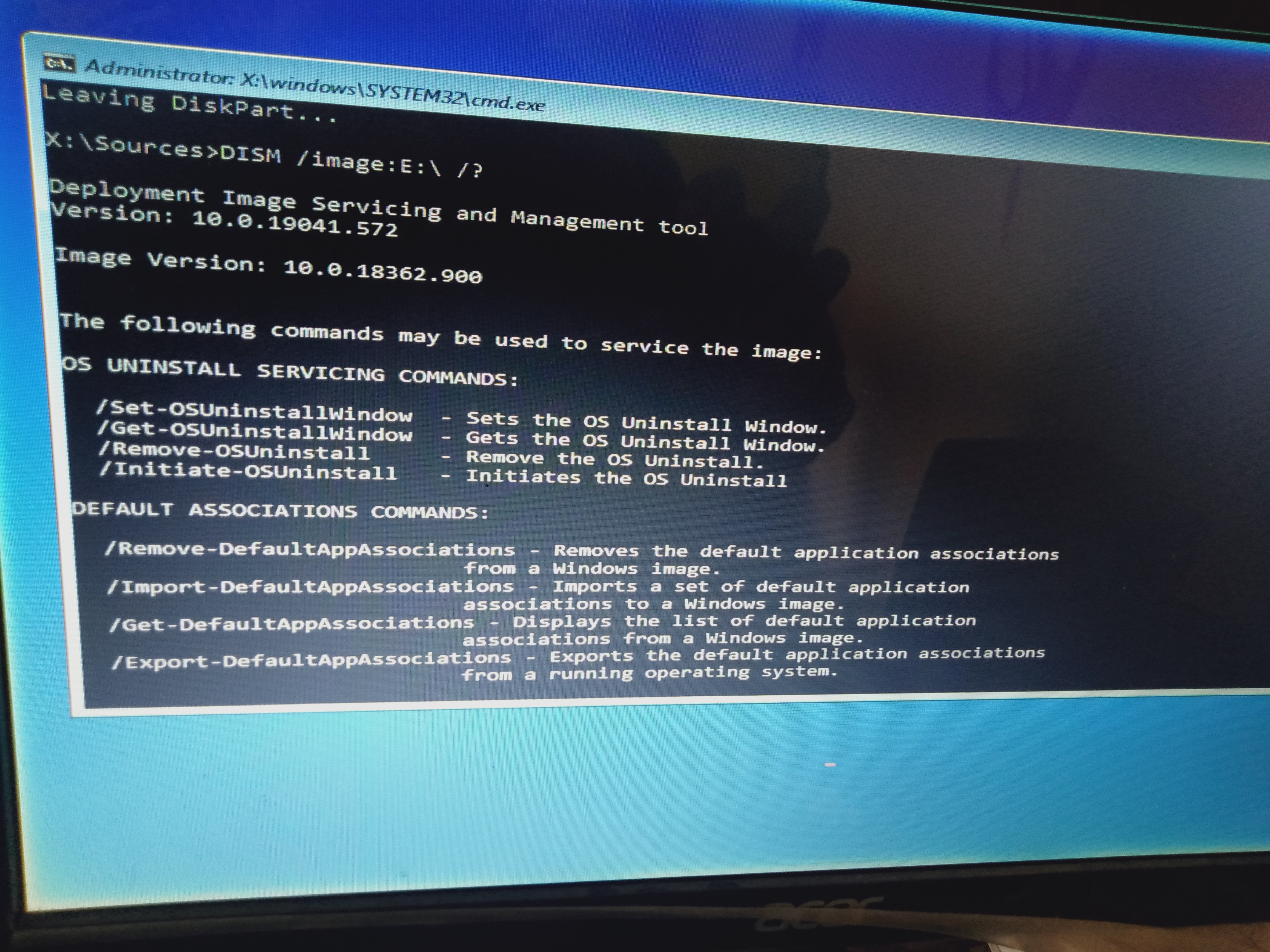

    Sir, i use this command DISM  /Image:E:\   /? But i didn't get any results regarding /Cleanup image i also tried with DISM /Image:E:\ /Cleanup-image /?

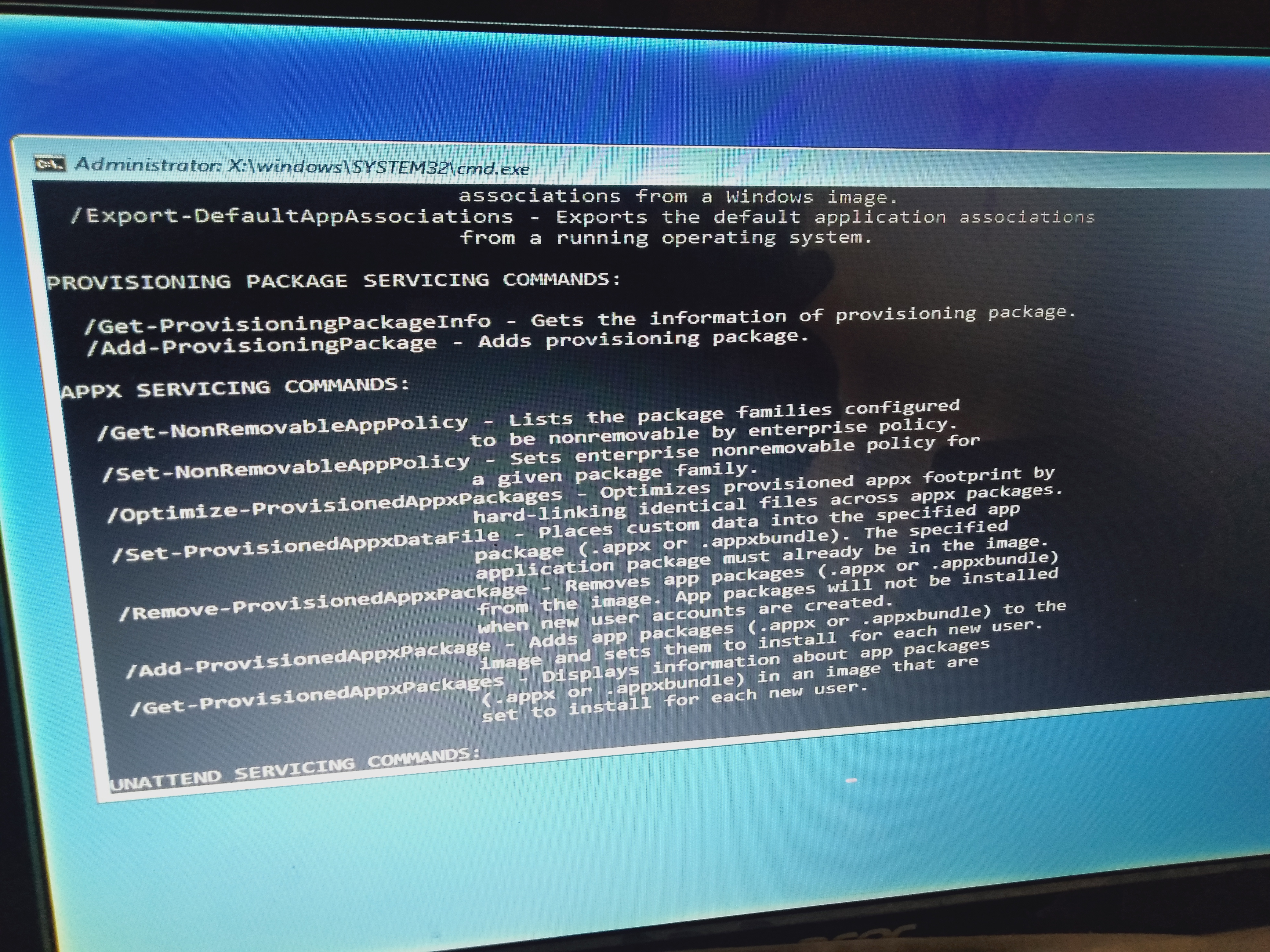

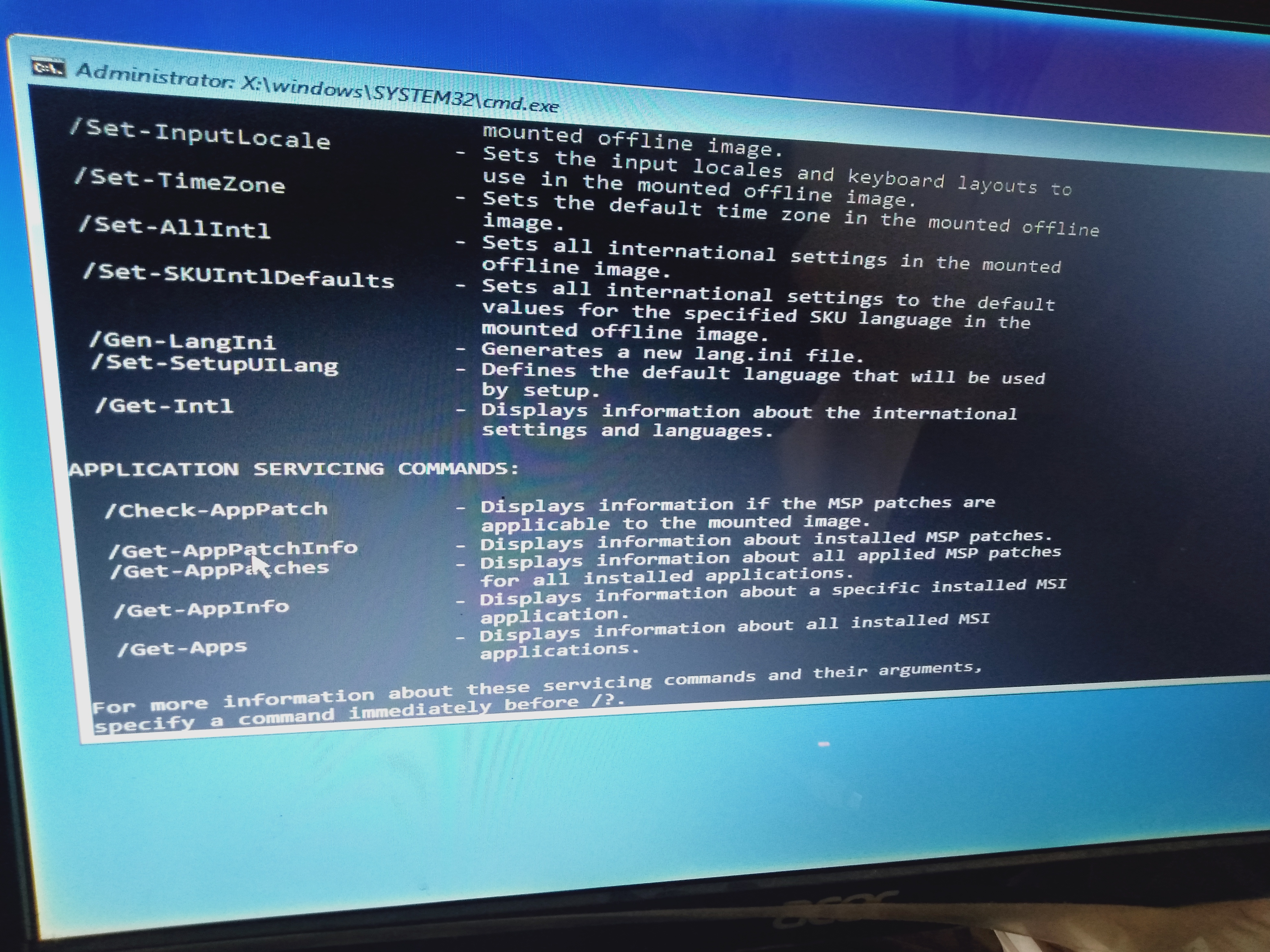

    (1) I went into a recovery environment & I did an offline /Cleanup-Image, So, yours should have worked too. Had it not liked your letter "E" in "/Image:E:", you'd have gotten a different error message. I don't see anything wrong with what you typed, but try...
    DISM  /Image:E:\   /?
    The word "/Cleanup-Image" will be in the output near bottom. Run the mouse over it to select, then use CTRL-C to copy it to the Clipboard. Then use Ctrl-V to paste it into this...
    *DISM  /Image:E:*  --paste--  /RestoreHealth
    If it works, try the offline SFC again...
    SFC  /ScanNow  /OffBootDir=E:\  /OffWinDir=E:\Windows
    Some say to try it 3 times in a row, if it says there is an uncorrectable error.
