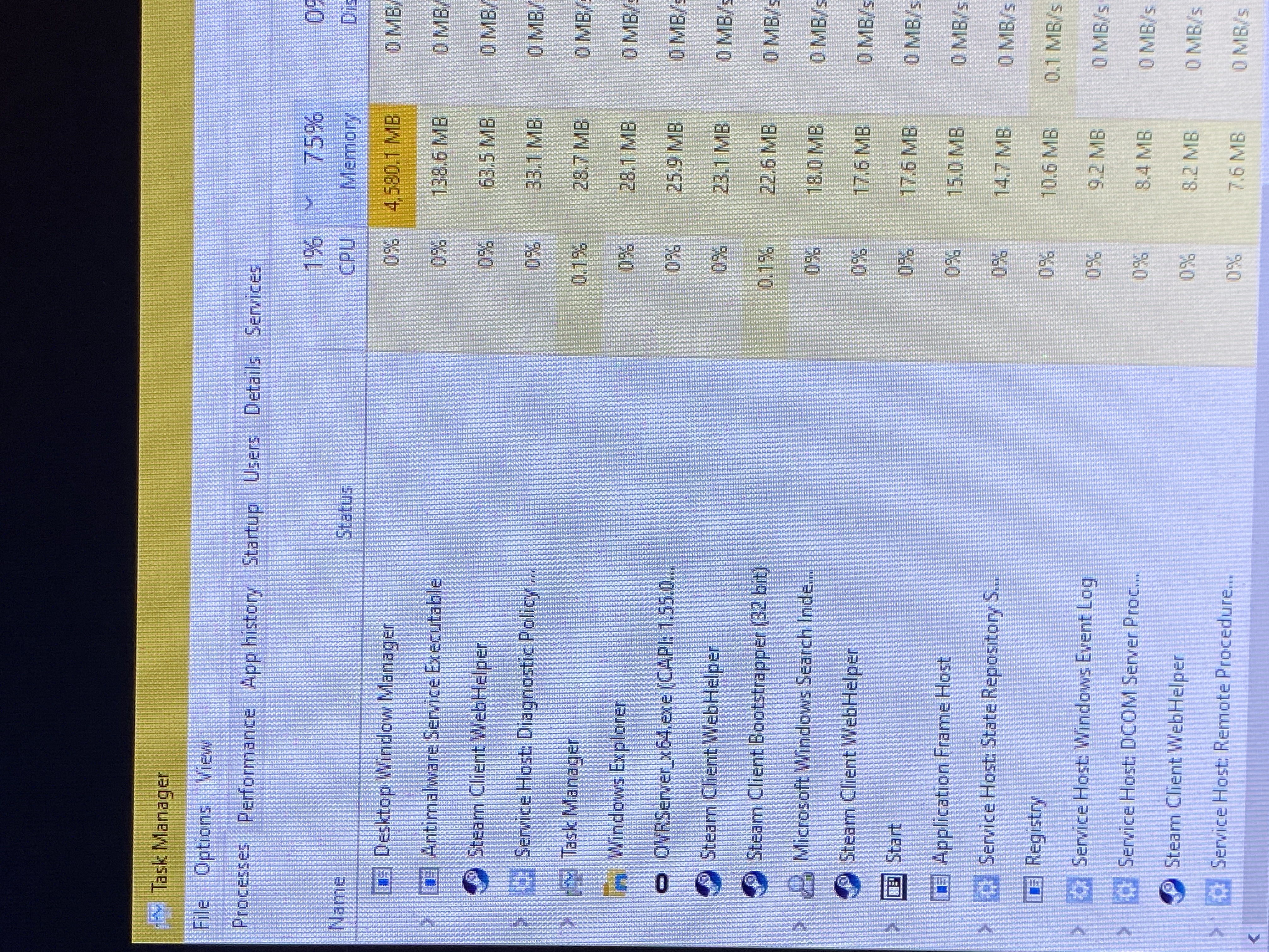

Recently I felt a big performance decrease on my pc.
My configuration:
i3-8100
GTX1660Ti
8Gb RAM
I have 2 screens:
  1. 1680x1050
  2. 1920x1080
When I start Task Manager I often see 94% RAM usage and the first reason is Desktop Window Manager. It uses nearly 5Gb of memory.
If I kill this process it starts to use about 300Mb and then slowly rises to previous values.
I use Wallpaper Engine and tried to disable it, but got no result.
I also see dwm using more than 10-15% of CPU and GPU. I've done almost everythnig I found on web such as updating drivers or something but nothing's changed.
