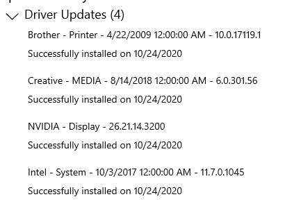

    2020-10-24T21:39:14+00:00
    Here were the 4 drivers that were automatically installed. Wondering if it maybe was the intel driver? Intel won't even allow me to update it directly from them for my motherboard. I'm able to use all of the standard drivers from NVidia/Creative/Brother with no issues. I pulled the motherboard intel driver and they installed. Although the Intel Management Engine INterface driver does crash from the MB manufacturer, but it allows me to restart with no issues. So I'll just leave that uninstalled.
    Either way, I'll wait for the t2 tech to call tomorrow. I do need to reinstall once we think it will work. I took out my new SSD at one point when I was up to 400gig in writes to it just reinstalling windows over and over. Also need to do a standard online install since I need a few things it left out.

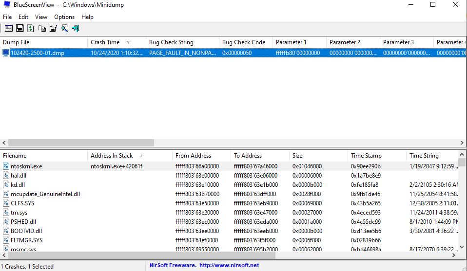

    I'm not sure what to look at on that blue screen window info.
    2020-10-24T20:43:38+00:00
    Not sure if this is more helpful.
    ntoskrnl.exe ntoskrnl.exe+42061f fffff80366a00000 fffff80367a46000 0x01046000 0x90ee290b 1/19/2047 9:12:59 AM Microsoft® Windows® Operating System NT Kernel & System 10.0.19041.572 (WinBuild.160101.0800) Microsoft Corporation C:\Windows\system32\ntoskrnl.exe

    2020-10-24T20:33:36+00:00
    Here is what it is showing. What should I export from this?
