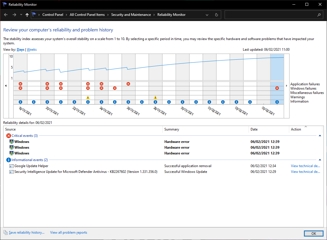

    Just reporting back in with Far Cry 5 test results. You can see from this screenshot that I had a crash today with Far Cry 5. It took around 15 minutes from booting my PC and starting to play to crash.
    This is after 10 days of no crashes. 5 of those 10 days were with a single 8GB stick of memory. The second 5 were with both of my 8GB sticks and only playing CoD Black Ops Cold War.
    So Far Cry 5 causes a crash for some strange reason. CoD Black Ops Cold War is fine. This is a massive pain in the ****. Apex crashed maybe 4 times in the past few months, so it's pretty rare but can happen.
