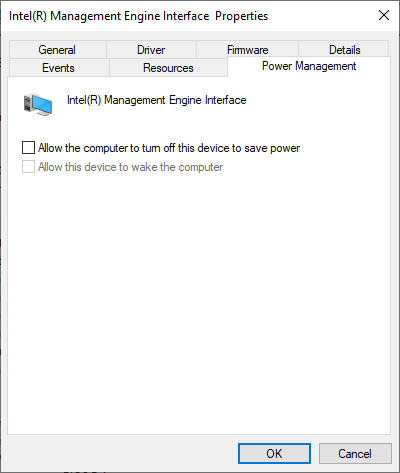

And one more thing I wanted to tell you why now I 1000% believe the issue lies in Intel mgmt engine Interface because, I told you that the issue only occurs while plugged in, but when I check the option "Allow the computer to turn off..." in Intel MEI power mgmt, I noticed that it started happening on battery also and so I immediately unchecked that option and the issue only occurred while plugged in. As Robin suggested a HP site link which told me to downgrade the version of this driver but the last ver I found for my PC was 11 but the HP site says 9.5 is most stable & works with most of the PCs so if you find it please share it.
My hardware ID(I don't know which one is used to find so I'm giving all that driver details section has):
1-PCI\VEN_8086&DEV_9D3A&SUBSYS_83F8103C&REV_21
2-PCI\VEN_8086&DEV_9D3A&SUBSYS_83F8103C
3-PCI\VEN_8086&DEV_9D3A&CC_078000
4-PCI\VEN_8086&DEV_9D3A&CC_0780

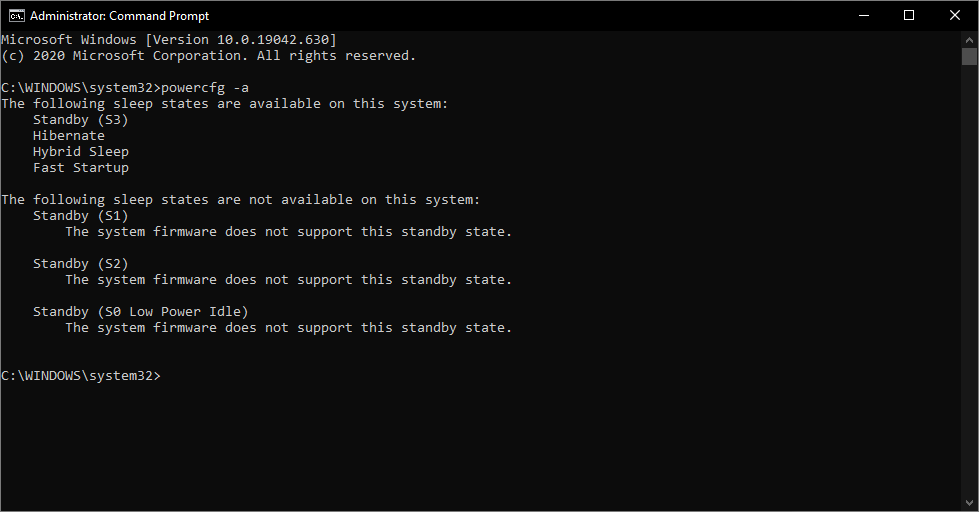

Hi, I know its been a while after the last post but my issue is still not fixed, but I think I found out what the problem is. I told you that my PC was working fine when HP software was not installed but another thing that i noticed then was when I woke my PC from standby the network was disconnected(this is when I didn't have the issue) so I suppose that the OS was going in S3 sleep state which my PC officially supports and now I think the OS is trying to put it to S0 sleep state which in cmd i saw it said that it is not supported in my firmware i think its going to S0 because some site said that in this S0 state network doesn't get disconnected as it is happening now to my PC.

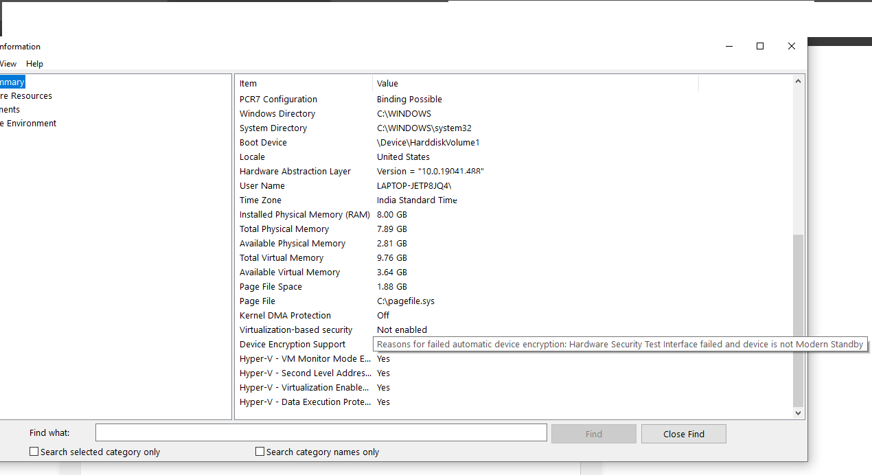

I double check it in system information and saw even device encryption is not running for some reasons because my pc doesn't support modern standby.
What do you think is it because win is trying to put the PC to sleep forcefully in S0 mode and that's where its getting stuck and not coming back or something else?
