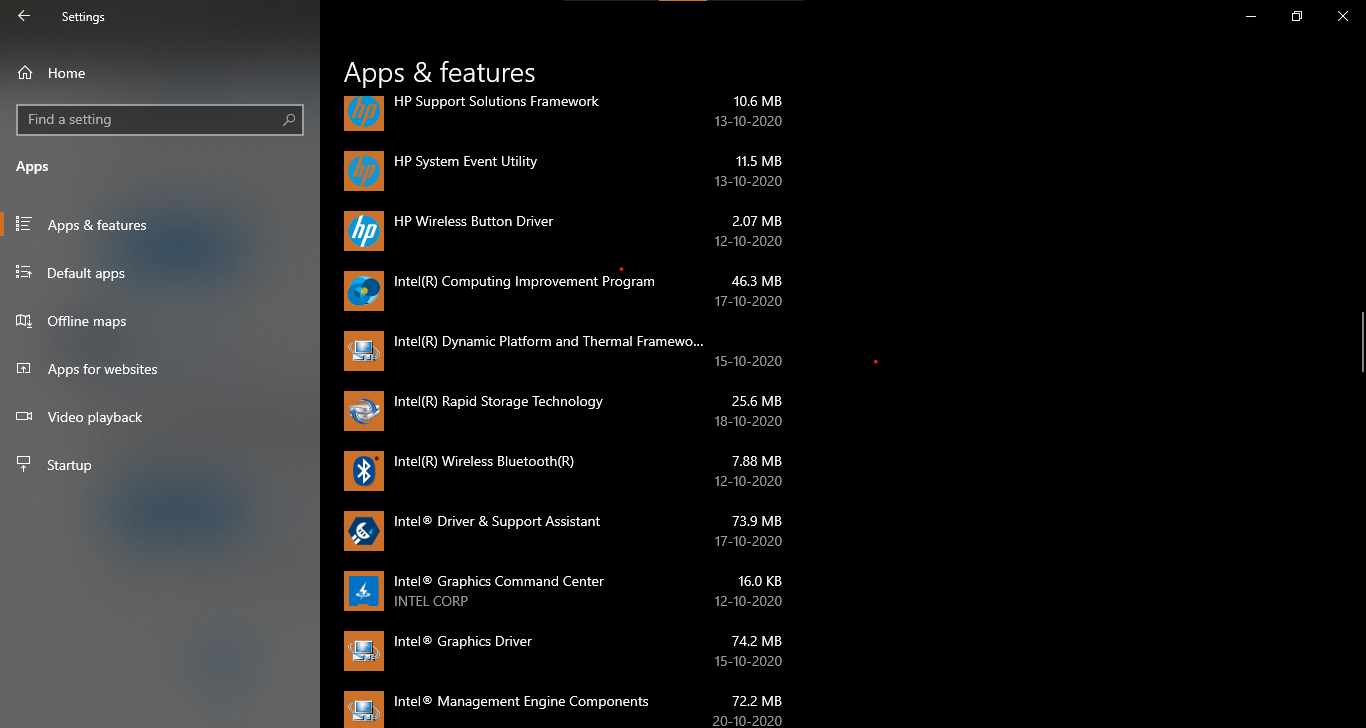

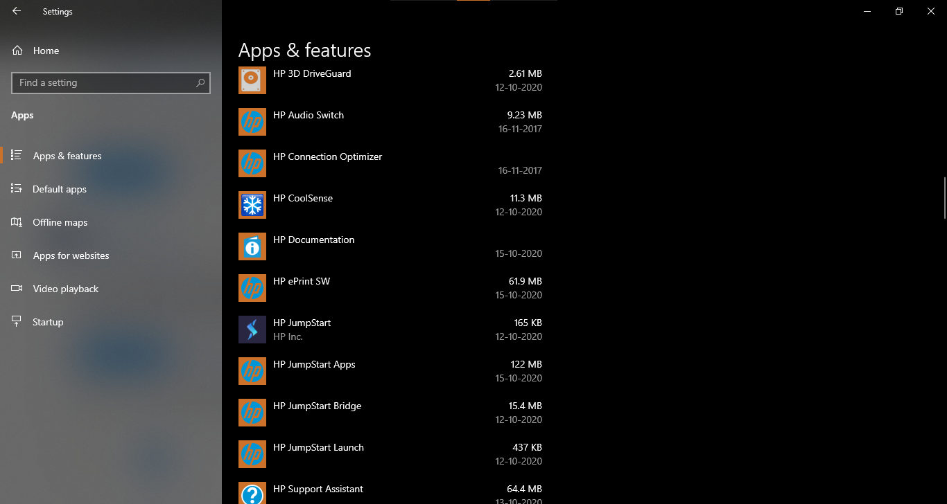

    2020-10-21T06:44:52+00:00
    Which of the following do you think might be causing this. I removed intel rapid storage and HP 3d drive guard but it didn't resolve.
