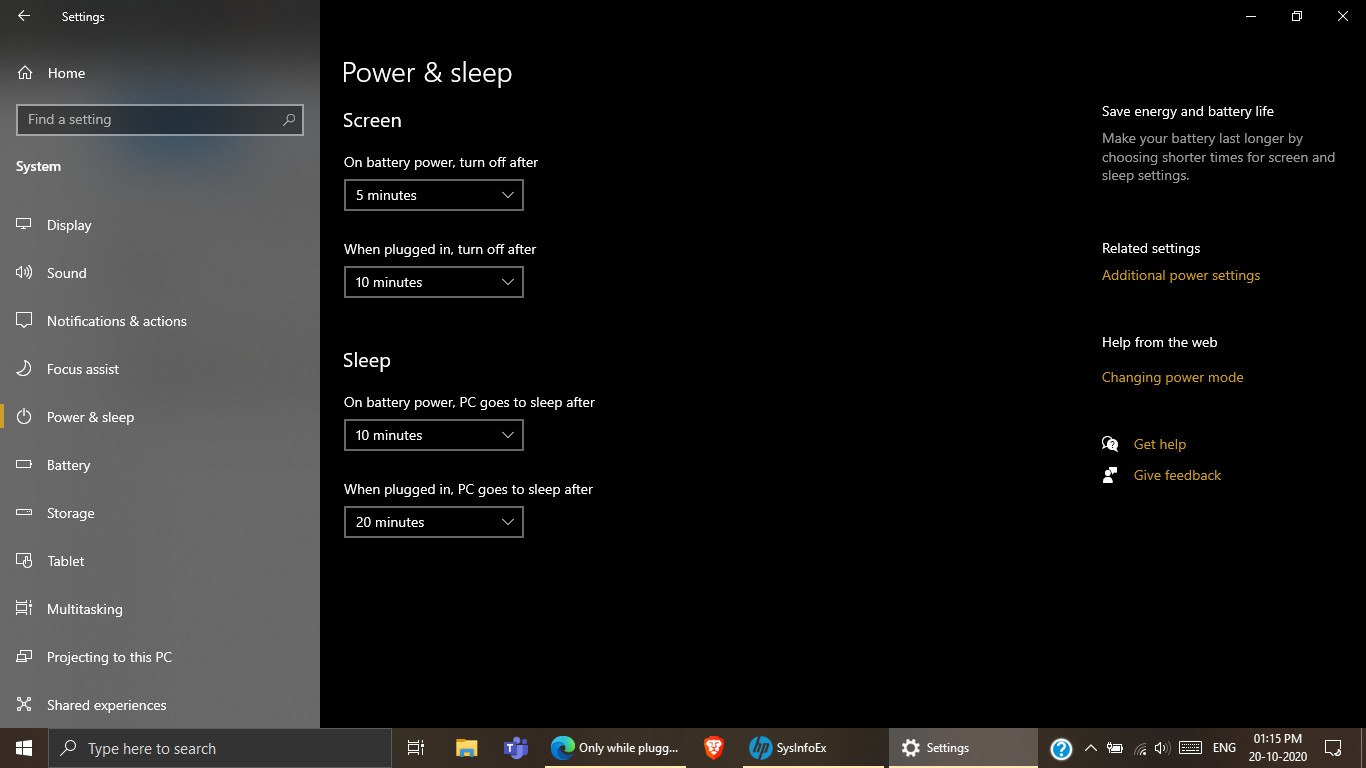

Here is the weird part--- This only happens if my laptop is plugged in and doesn't occur while on battery. The power options screen is shared below

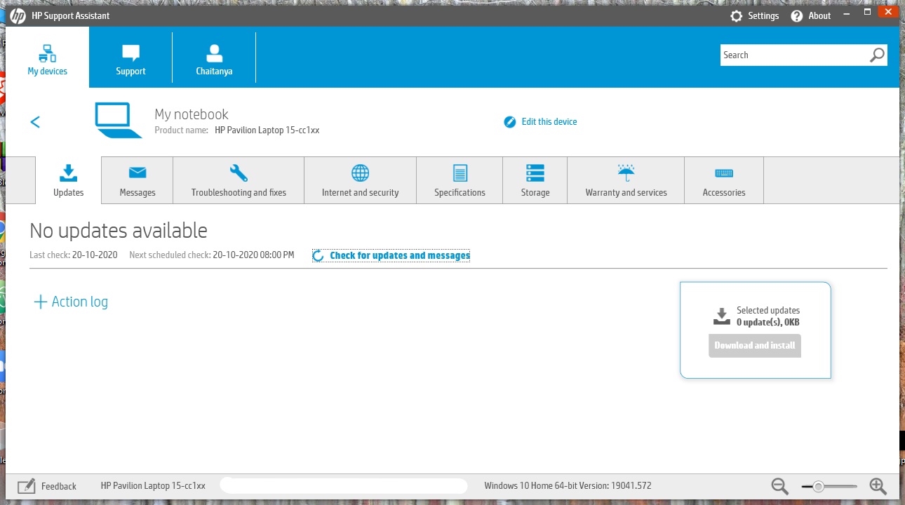

    If doesn't work download the HP support assistance from this link
    https://support.hp.com/vn-en/drivers/selfservic...
    Update Bios and Drivers
    I've updated every thing that can be updated there is no updates available anywhere. This simply doesn't resolve.
    Before I thought it was a hardware issue but 6 months back I clean installed win 10 from Microsoft site (with absolutely no OEM/HP softwares) via USB and the issue was no more present it worked completely fine, I did this because I didn't find any fix for the same problem I've mentioned in this post. But just recently I had to a factory reset using HP cloud recovery tool, now, that reinstalled all HP softwares and the same problem started again. I guess the problem is in the "HP recommended" power plan which has replaced "Balanced" power plan, some setting is not working in my PC.

    Try Power and sleep in Settings, System.
    2020-10-20T07:47:24+00:00
    You did not go to Settings, Power & sleep;
    No I changed it from power options only isn't that the same as win settings
