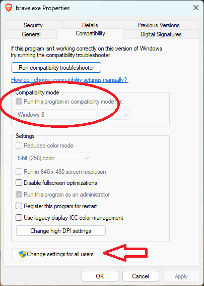

2024-10-16T07:58:04+00:00 OK, I have a working solution that actually prevents this efficiency mode from starting. This is not a fix but a work around.
Now, this really is super simple. When I started this, Windows was changing my settings back to normal like it does when you try and turn off this E-mode using task manager. And I found a solution to this too. Still just as easy.
All you have to do is set this to run in compatibility with Windows 8. But as I said it may switch back. If you look at the bottom of the properties window, it has 'Change settings for all users' and you fill this in with the proper settings. Now if you look at your settings page, you may need to reload the properties window, but you should see the settings greyed out. This seems to lock them in and windows does not change the settings back so far.
I retested this several times and have no trace of the efficiency mode coming back on. I do believe this will work for everybody. No leaves. No regedit. No settings deep in some application or stowed away in some file in a long lost hidden directory. It is simple. Run for windows 8 and run for all users.
I set Edge back to default and this solution here seems to be the answer to this problem and it should work for every application that has the problem with this unbelievable **** that MS has done to all of us. I believe this is the working solution to the problem so far. Windows could change this in another so called fix they give us. But it works as of right now. I have an up to date Windows 11.
This image pretty much shows all you have to do.
