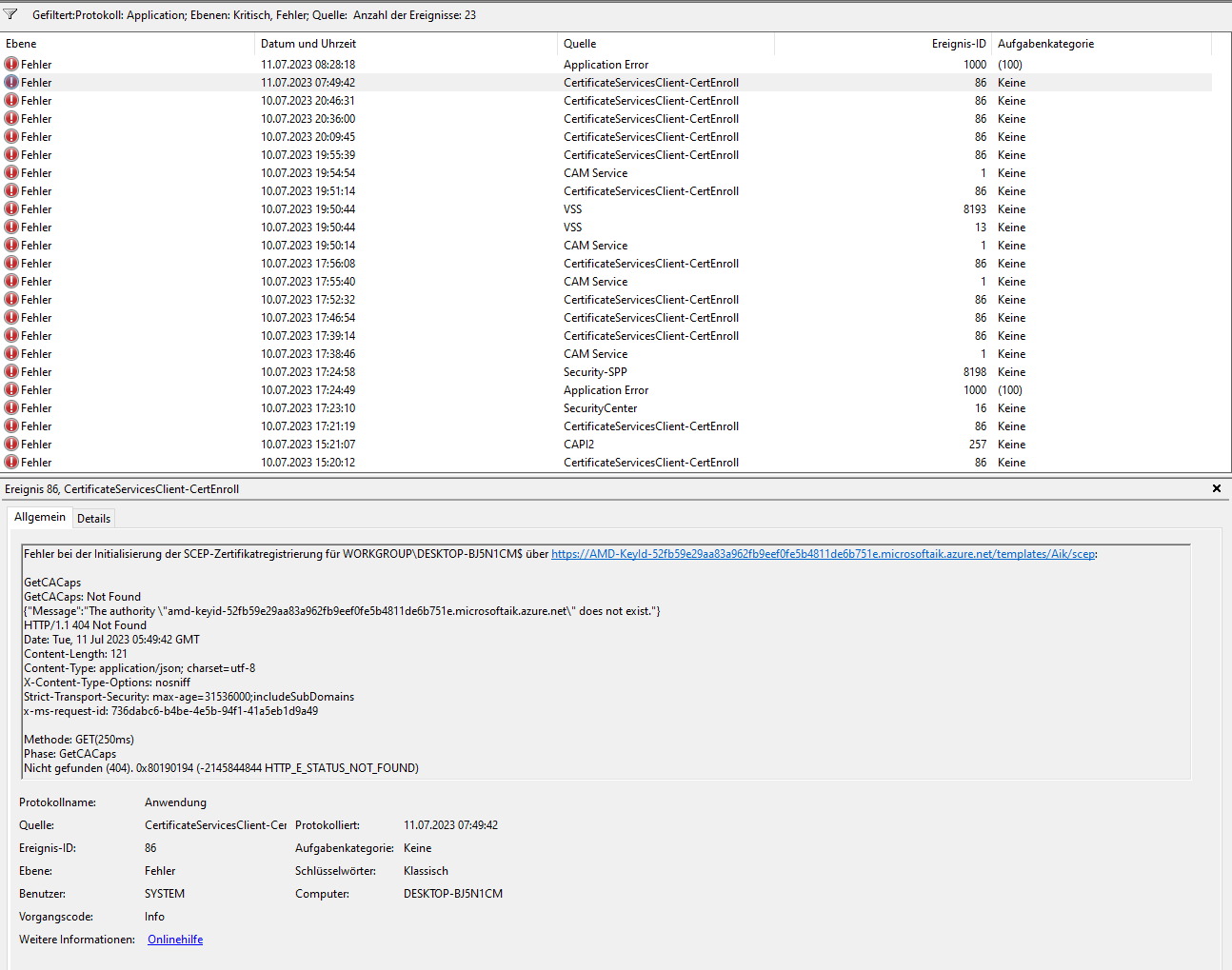

    Can you tell me how to "check the SCEP configuration" on an consumer product like Window 10 ?
    Here the error message the eventmanager records:
