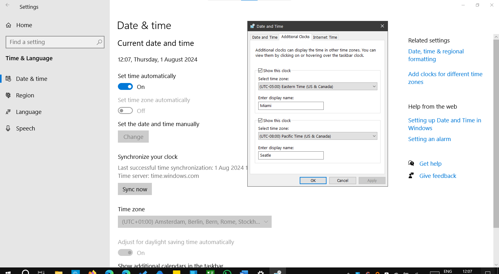

    2024-08-01T10:13:54+00:00
    in Date & time select, upper right side, under Related settings, select, Add clocks for different time zones, in the window that opens: Date and time, chose the time zones you want to display / add.
