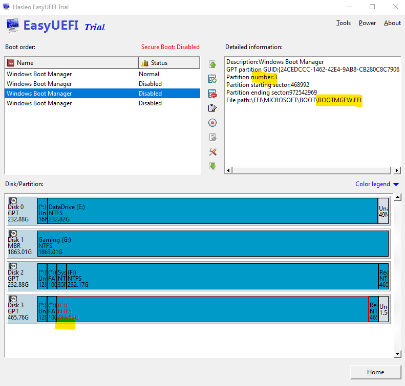

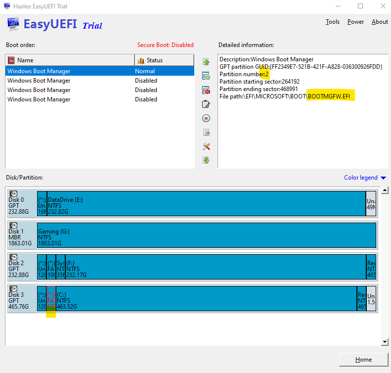

(1) This should move {bootmgr} back to the top of DisplayOrder...
BCDEdit /Set {FWBootMGR} DisplayOrder {BootMGR} /Addfirst
That is where it belongs. I don't know how it got to the bottom. Do a full reboot for it to register in BIOS. Then, show us a new BCDEdit /Enum All.
That's nasty that BIOS adds one back after you have deleted it.
(2) The order of the GUIDs in DisplayOrder does not have to be the same as they are in the body of the BCD. In the body, they are in the order the boot entry was created. Moving one to the top of DisplayOrder should also move it to the top in BIOS Setup (after a full reboot). It then becomes the one that will boot by default. That is, it's the one that boots unless you chose another by using the one-time BIOS Boot Options menu. I think in your Asrock that is invoked with F11. (And DEL or F2 goes to BIOS Setup).
(3) I'm confused about your BIOS. I don't have one that complex.
(a) I don't know why it's got 4 Boot Options.
(b) Are you sure it is Boot Option #1 that is executing? Maybe disable ...#2 to be sure.
(c) Show us the contents of ...#2 as you showed ...#1 below.
(d) What is that item that is disabled within ...#1?
Our goal is to have you boot to the EVO that has Windows on it. So, that is the drive that needs to be at the top of the Boot Order in your Boot Option #1. Is it...?...
The way to know that it is the correct Windows partition that is booted is that your C: partition will be 463 GB...
