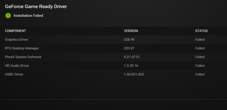

    I do the sfc scannow and other dism commands to make sure everything is fine. typically, i would have some errors, however, the most recent installs have been fine. no errors. But like always, i still have the issue with my geforce drivers failing initially. its like they have to be reinstalled multiple times before it works. Eventually, it installs and i try to play games like hogwarts/callisto/etc. anything that has dx12 and preloads the shaders just instantly crash with the "Out of video memory" error.

    i checked device manager and i see this:
    not sure what thats from. and also, my drivers for nvidia are still failing, however, the microsoft updates have updated with no issues.
    the biggest constants are the page fault error when installing windows and the driver issues from nvidia which all of this could be tied together somehow.
