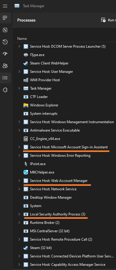

    Not sure what task... These are the processes that are concerning me.
    And a specially the Local Security Authority Process, that contains
    • Credential Manager
    • Security accounts Manager
    • CNG key Isolation
    You could be right, a task is doing this. because it happens after a minute or so after opening settings. I have thought about too, but don't know where to look.

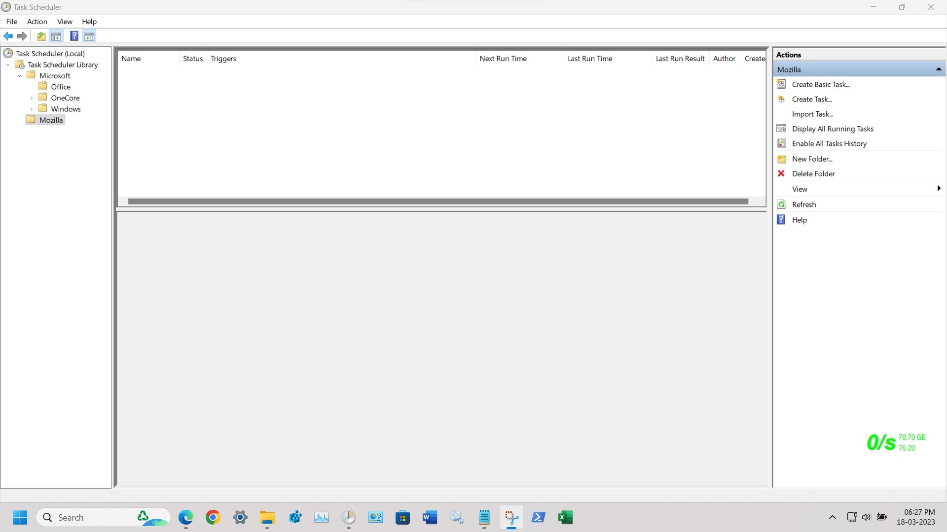

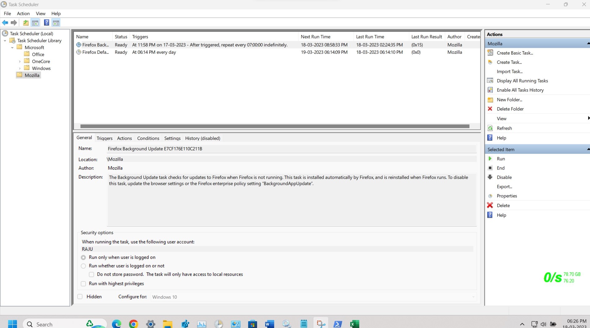

  5. VARADHARAJAN K 9,726 Reputation points Volunteer Moderator
    2023-03-18T12:58:51+00:00
    See the Above picture, which describes the task scheduler application, few tasks are registered , browse to each folder, on the right side if you see any items then delete it.
    Note only a few tasks cannot be deleted because users do not have the permissions.
