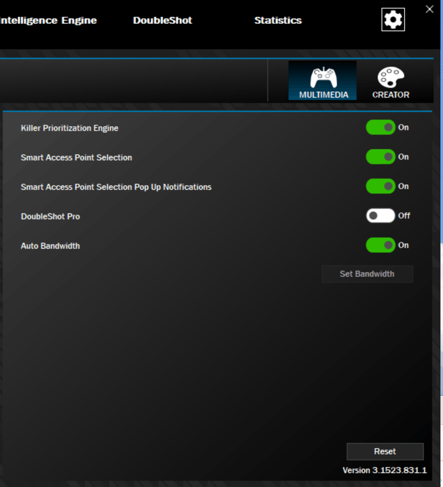

2023-12-12T11:39:41+00:00 Your solution worked! I turned off the Killer Prioritization Engine (in Killer Intelligence Centre) and my upload speed went back up to normal high speed.
Many thanks.
DELL XPS 8930

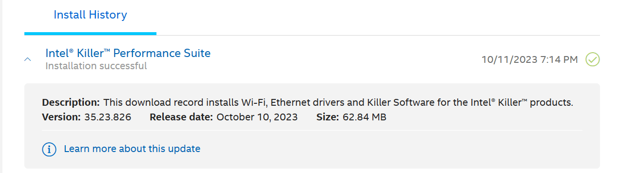

2023-10-12T02:40:31+00:00 Surprised I figured it out. My PC (Dell) uses the Killer E2400 Gigabit Ethernet Controller. Turning off the Killer Prioritization Engine fixed this problem.
I had to do the same till I got this latest version of the killer Performance Suite which seems to not affect my E2400 ethernet anymore.
My Upload speed is now the one promised by my provider without disabling the Prioritization Engine. 👍
