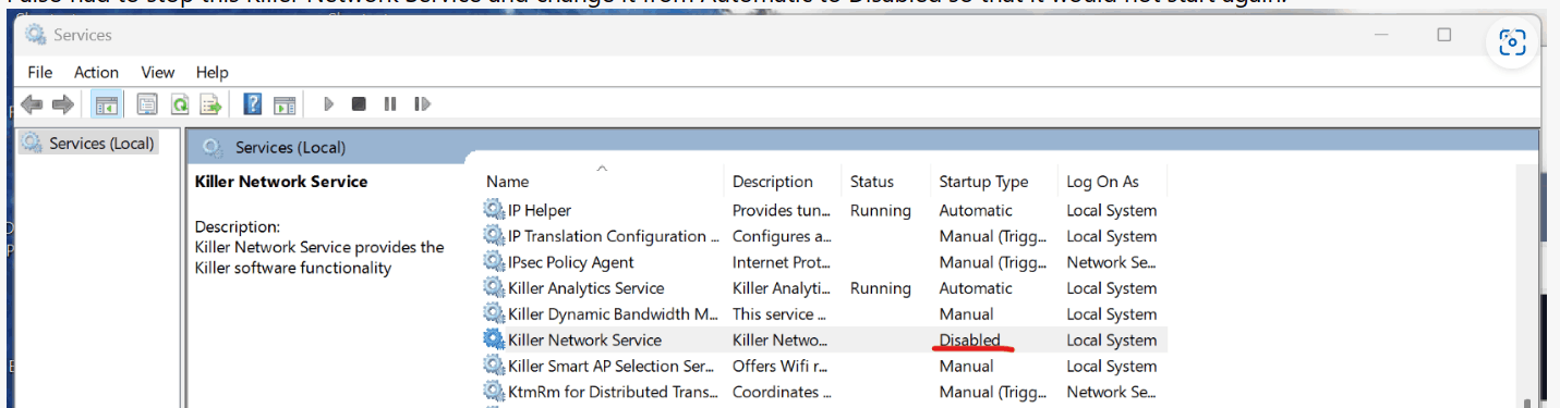

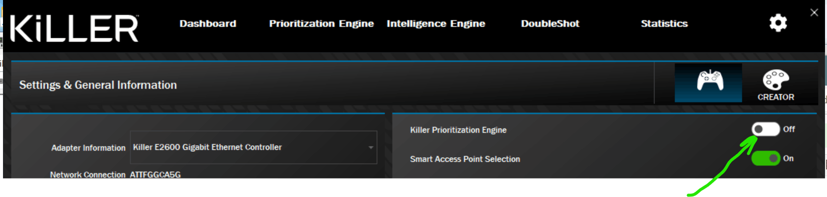

    To avoid the problem with the E2400 Ethernet, I had to take the 3 actions below.
    1. I turned off Killer Prioritization Engine

    3. I disable the Killer Network Service
    Clearly this is not necessary if you use Wi-Fi instead of the E2400 Ethernet.

    I have been wrestling with this issue for months! My upload speed (FTTP) on ethernet was a glacial 0.2Mb (>32Mb on WiFi).
    Simply turning the Killer prioritisation Engine slider to 'Off' gave me my 149Mb download speed back!

    Hi, I just had the same upload speed problem, under 1Mb. Has the internet provider here most of the day only to find out at the end that the problem wasn't on the wireless internet connection which is a qualcomm adaptor. So the problem became definitely on Killer ethernet adaptor only. I did install the Killer Intelligence Center ,as it is called now, from intel. The file name is "KillerPerformanceSuite_34.22.1163_Win10-11x64.exe" to install it. I disabled the prioritization engine and ran the speed test and immediately the speed was back to my normal ISP provided speed.
