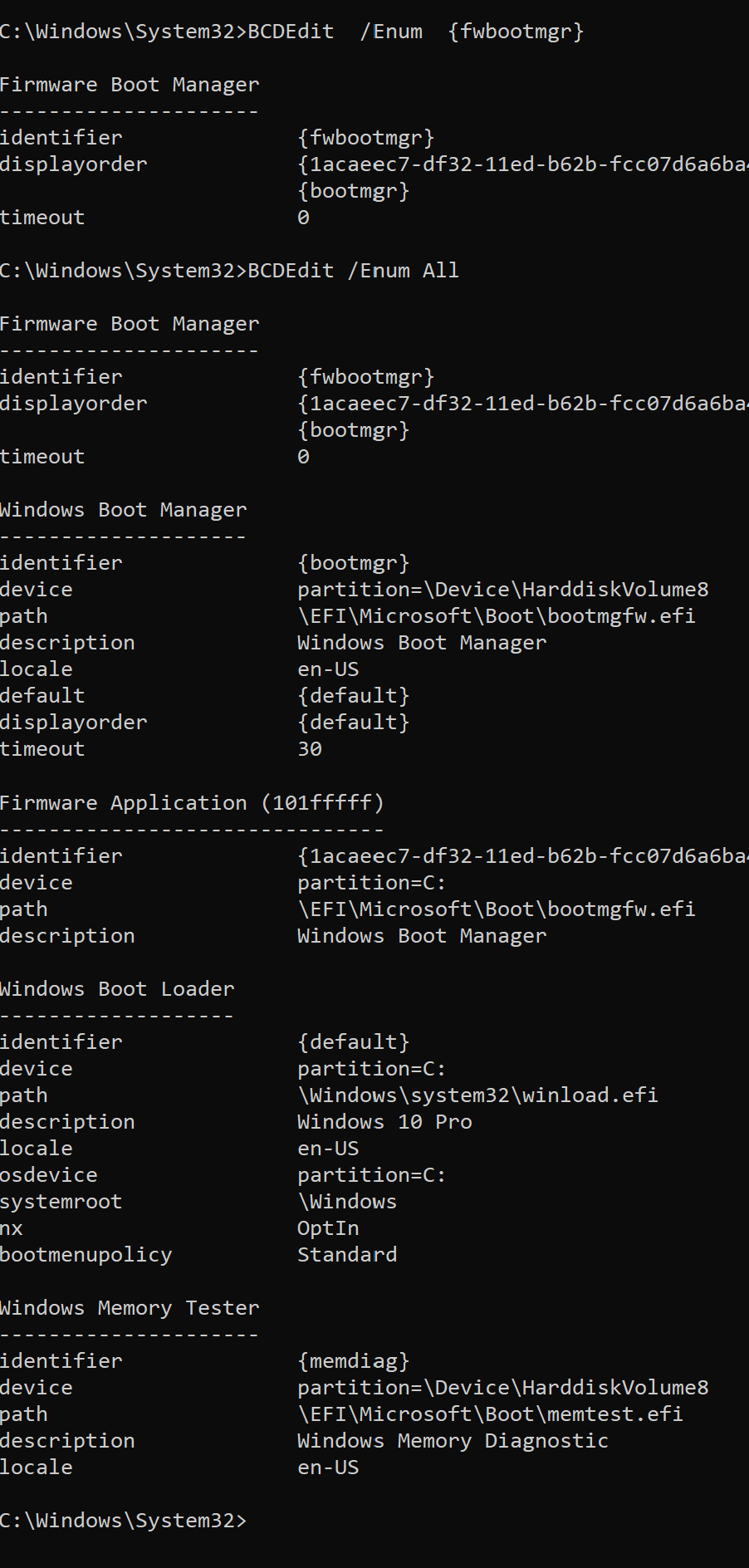

    (1) Now that you've got a new BCD, show us: BCDEdit /Enum {fwbootmgr}
    That is a window to the BIOS Boot Order screen. The earlier BCD showed BIOS was set to boot directly to C instead of to the Windows Boot Manager (bootmgr). A UEFI installation should always boot to the boot manager.
    If it still looks like that, move {bootmgr} to the top of the Displayorder this way...
    BCDEdit /Set {fwbootmgr} Displayorder {Bootmgr} /Addfirst
    BCDEdit /Enum {fwbootmgr} <<<Confirm it has moved to the top
    Reboot to put it into effect. It will automatically change in BIOS. Then show us the full BCD...
    BCDEdit /Enum All

    2023-04-20T10:54:51+00:00
    The above is before a reboot with those commands.
    Below is after a reboot

    Edit- I feel like the identifier for the BCD shouldnt be all zeros? Is that a sign of something being broken?>
    2023-04-20T22:41:51+00:00
    (1) No, the zero GUID /Info reported means none was found in the BCD for the Recovery partition.
    (2) The log isn't at gofile that I can find. And I'm leery of connecting to a strange cloud storage other than OneDrive anyhow. Just copy/paste C:\Windows\Logs\ReAgent\Reagent.log into the Search bar. Copy out the three command's output from the bottom, then paste it here.
    (3) That BCD /Set command moved {bootmgr} to the top of Displayorder where it does belong. I'm puzzled that it didn't remain there after a reboot.
    (a) Are you sure it was a reboot -- not a shutdown, then boot? Those are normally different.
    (b) I'm thinking (not really sure) you've got two BCDs. One is on HarddiskVolume8 which the {bootmgr} would use. That should be the EFI partition. The other is on C: which the direct boot to C: uses...
    I think HarddiskVolume8 is indeed the EFI partition, otherwise {bootmgr} would also say C: is the device. Let's put a letter on EFI to access its BCD directly. EFI is the FAT32 partition...

    2023-04-20 06:53:21, Info [ReAgentc.exe] Partition number: 1, offset: 16384, free space: 0, total space: 6311936
    2023-04-20 06:53:21, Info [ReAgentc.exe] DiskNumber:8, DiskSignature:0, NTFS:1, Mbr:0, Active:0, Boot:0, BitlockerEnabled:0
    2023-04-20 06:53:21, Info [ReAgentc.exe] GPT partition GUID:: {EBD0A0A2-B9E5-4433-87C0-68B6B72699C7}
    2023-04-20 06:53:21, Info [ReAgentc.exe] DiskId: {6AE96F95-20AA-DC74-422C-ADBDE915273B}
    2023-04-20 06:53:21, Info [ReAgentc.exe] --Partition info--
    2023-04-20 06:53:21, Info [ReAgentc.exe] VolumeName: \?\Volume{10e2292e-545c-461d-b757-29e6d301a847}, PartitionName: \?\GLOBALROOT\device\harddisk7\partition2
    2023-04-20 06:53:21, Info [ReAgentc.exe] Partition number: 2, offset: 16777216, free space: 4026781859840, total space: 5000928423936
    2023-04-20 06:53:21, Info [ReAgentc.exe] DiskNumber:7, DiskSignature:0, NTFS:1, Mbr:0, Active:0, Boot:0, BitlockerEnabled:0
    2023-04-20 06:53:21, Info [ReAgentc.exe] DiskId: {11D92676-230A-47A0-A355-2F81A86F3ECF}
    2023-04-20 06:53:21, Info [ReAgentc.exe] VolumeName: \?\Volume{98742bc3-3a5f-4ad5-bba7-88c203eef8dd}, PartitionName: \?\GLOBALROOT\device\harddisk6\partition4
    2023-04-20 06:53:21, Info [ReAgentc.exe] Partition number: 4, offset: 999393591296, free space: 92938240, total space: 808448000
    2023-04-20 06:53:21, Info [ReAgentc.exe] DiskNumber:6, DiskSignature:0, NTFS:1, Mbr:0, Active:0, Boot:0, BitlockerEnabled:0
    2023-04-20 06:53:21, Info [ReAgentc.exe] GPT partition GUID:: {DE94BBA4-06D1-4D40-A16A-BFD50179D6AC}
    2023-04-20 06:53:21, Info [ReAgentc.exe] DiskId: {866B2729-4C6F-48B5-A501-61B04E6D6D23}
    2023-04-20 06:53:21, Info [ReAgentc.exe] VolumeName: \?\Volume{2f72fe48-bd38-418e-b5ac-4af859a680b6}, PartitionName: \?\GLOBALROOT\device\harddisk6\partition2
    2023-04-20 06:53:21, Info [ReAgentc.exe] Partition number: 2, offset: 17825792, free space: 263297245184, total space: 998724931584
    2023-04-20 06:53:21, Info [ReAgentc.exe] DiskNumber:6, DiskSignature:0, NTFS:1, Mbr:0, Active:0, Boot:1, BitlockerEnabled:0
    2023-04-20 06:53:21, Info [ReAgentc.exe] VolumeName: \?\Volume{1dddd0b0-0000-0000-0000-100000000000}, PartitionName: \?\GLOBALROOT\device\harddisk5\partition1
    2023-04-20 06:53:21, Info [ReAgentc.exe] Partition number: 1, offset: 1048576, free space: 967488057344, total space: 2000396742656
    2023-04-20 06:53:21, Info [ReAgentc.exe] DiskNumber:5, DiskSignature:501076144,
