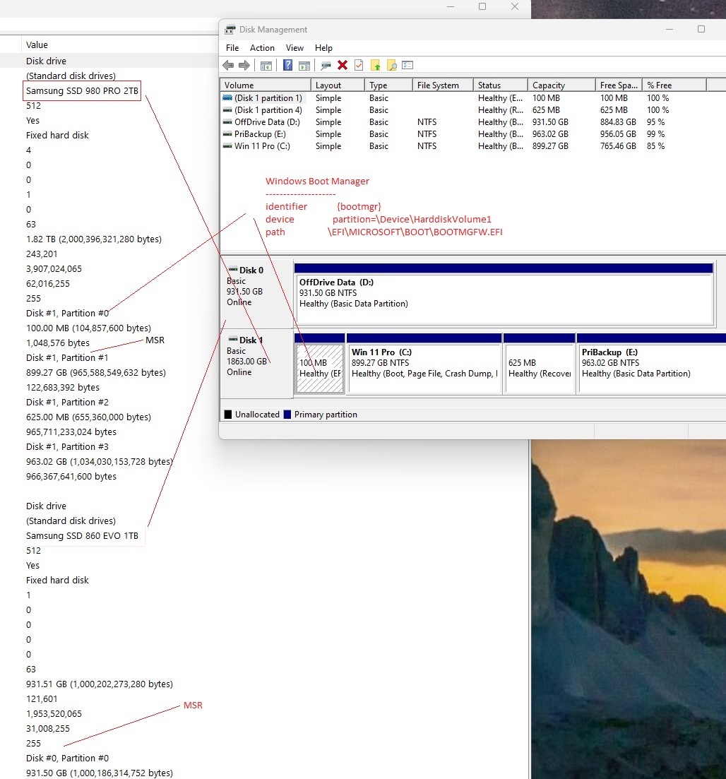

    I think MSInfo32 is inadequate to the task because it counts partitions starting with 0, & it leaves out my MSR (of 16 MB)...
    Disk Management also leaves out the MSR (because it has no file system I think), but at least it puts the correct partition number on the Recovery partition. It's Disk 0, Partition 4...
    2023-04-24T03:38:27+00:00
    That is pretty much what I was showing. The important thing here, since you count HardDiskVolume based on drive priority and partitions on that drive, you need to know the pecking order, and I think that is what msinfo32 shows you.
    If you get the drives in the incorrect order, you will get the wrong partition.
