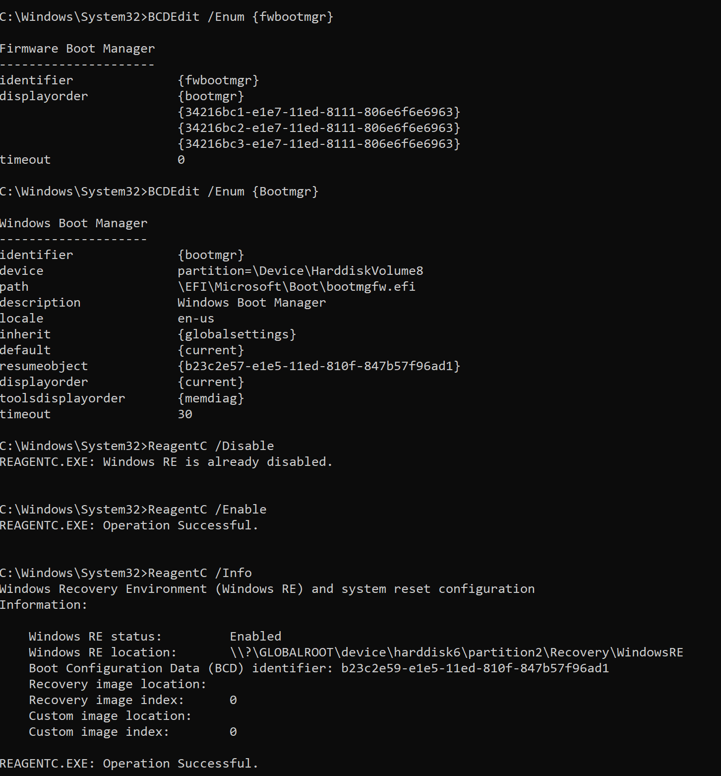

(1) You've got two System partitions each with its own BCD. C partition is doubling as a System partition, & EFI is a System partition...
That is likely what is confusing ReagentC. It needs to find the BCD in order to enable the Recovery partition. We need to tell Windows that EFI is to be used -- not C. Let's try this...
DiskPart<<<Enter DiskPart
List  Vol<<<List the volumes & letters
Select  Vol  7           <<<Select EFI -- I guess it's still Volume 7
Assign  Letter=S     <<<Give it letter S -- unless List Vol shows it's already there
Exit<<<Exit Diskpart
BCDBoot  C:\Windows  /s  S:  /f  UEFI <<< **** Rebuild the BCD in EFI & all other boot files.
A reboot will be necessary to inform the rest of Windows of the change.

(2) After the reboot (presuming it did)...
Does BCDEdit /Enum {fwbootmgr} now show {bootmgr} on top?
Does BCDEdit /Enum {Bootmgr} name either HarddiskVolume9 or S: as the Device?
If so, try again...
ReagentC /Disable <<<Moves WinRE.wim to staging area
ReagentC /Enable <<<Moves it to the Recovery partition
ReagentC /Info <<<Show whether it is enabled
If it isn't enabled, let's see C:\Windows\Logs\ReAgent\Reagent.log. Just copy/paste the output of those three commands from the bottom of the log.

Looking at your prior listings, I now think the 8th partition down will be C. And EFI will be partition 9. Disks 0-5 will have 1 partition each, then Disk 6 shows...
So -- HarddiskVolume8 is the Windows partition. (EFI is HarddiskVolume9). Yep, the BCD that is on C (shown with /Store) shows the letter...
The one that is on EFI (S:) shows...
We want the one on EFI (S:) to be the only one. Windows gets confused when there is more than one System partition.

    @Lumince: WinRE is now located in the C: drive (which should also work fine) due to an alternate method/commands we used.
    If you'd like to move WinRE to its own ("Recovery") partition, please let's know.

    You are welcome, Lumince. And I thank Ramesh for his kind words. Things are clearly better than before. But this isn't a perfect outcome. It looks to me the Windows (C:) partition is now tripling as the System, Windows, & Recovery partitions!
    (1) As Ramesh spotted, WinRE.wim is at **C:**Recovery\WindowsRE. That's OK, but it would better to be on the Recovery partition. Let's examine the logs to see why it didn't go there...
    (a) Paste "C:\Windows\Logs\ReAgent\Reagent.log" into Search, then hit Enter.
    (b) Copy out the bottom 3 command results & paste it here.
     That should be the latest /Disable, /Enable & /Info.
    (2) At least now the system is not confusing your two BCDs. But I think it is the one that is at **C:**EFI\Microsoft\Boot that is in effect. Someday there might again arise a confusion with the one that is on EFI. Let's count your partitions this way...

    Regarding #1, WinRE now in the C: drive because of the "reagentc /setreimage" command I suggested earlier (REF: page 3 of this thread) for testing purposes. Thought we could move it back to Recovery once the other things are sorted.
