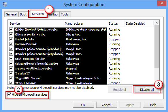

    And then launch MSCONFIG → Services.
    Enable "Hide all Microsoft Services"
    Click "Disable all"
    Click OK.
    ... reboot Windows.
    Re-run the setup.
