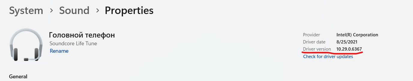

    2023-09-22T07:07:48+00:00
    Hi!
    As I said, I just decided to experiment, so some of my actions could have no logic at all ))
    I took the version from this place on my wife's laptop where I didn't face with mic issues.
    And googled it. In the search results my attention was attracted by the link that led to the intel audio driver and my thoughts were like
    "ou, what if I try to install this on my laptop?"
    I admit that it was quite a foolish decision ))
    The only use of it was just that it completely removed all Realtec drivers. After that, I tested my headset and discovered that the mic started to work fine.
    I kept my experiments and reached a result that satisfied me. All my laptop audio devices are working properly now including the BT headset mic.
    I guess after the next Windows Update the issue could return but will see.
    The screenshot shows my current values and the driver date looks a bit out of term)))

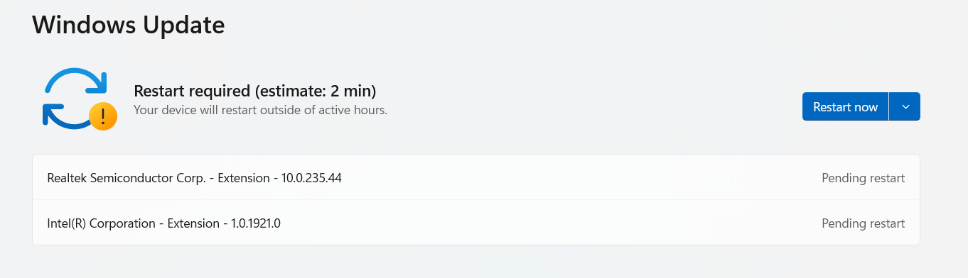

    I have just installed these updates
    and after that sound on my laptop disappeared
    Ok, I fixed it by installing the audio drivers from the Asus official page, but I assume that the next WinUpdates will destroy it all again. Keep watching ))
