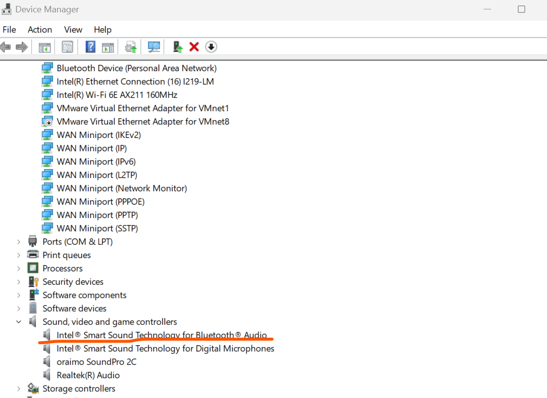

    This worked for me :
    In device manager > Sound, video and game controllers, roll back driver for Bluetooth audio.
    If you device was working prior to the update then it will start working again.

    Thanks, this Idea worked
    but i only delete the relevant driver for my bluetooth
    and also delete the driver for the Bluetooth Audio
