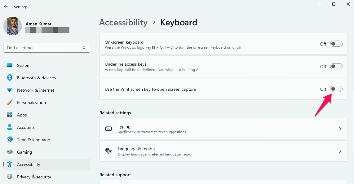

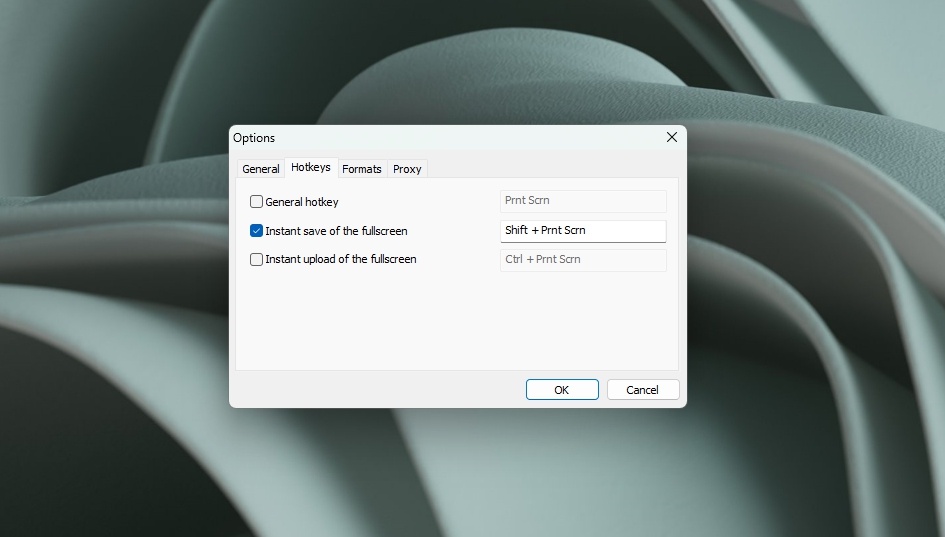

    2023-08-26T18:15:38+00:00
    Hey Everyone, I was able to fix this issue by disabling the Use the Print Screen to open screen capture option in the Settings app. However, if you will simply go and disable this option, Lightshot will work one time but after that the problem will return. To fix the issue permanently, first uncheck theGeneral hotkey box in Lightshot settings then disable the Use the Print Screen to open screen capture option in the Settings app. Then, check the General hotkey box in Lightshot settings. After that, you'll notice that you're no longer facing the issue.
    ![Image](https://learn-attachment.microsoft.com/api/attachments/7eaa85b6-4528-4fe4-afec-88448f2e8219?platform=QnA
    You can get more detail on this method by checking out this guide -- <link removed>

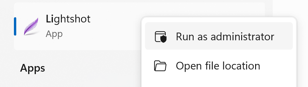

    2023-08-26T09:24:03+00:00
    The interesting thing happened to me yesterday. I installed some other updates and restarted my laptop. And then Lightshot stopped working and I couldn't see it in the System Tray. I ran it manually and it didn't help. Then I ran it with Admin permissions and it's working again.
