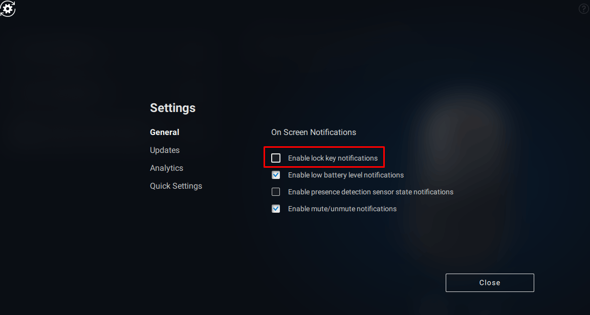

I had the same thing happening on my Dell laptop. I had to go to Computer Management -> Services -> Dell Peripheral Manager and stop the service. That immediately stopped the annoying notifications. I set that service to start manually instead of automatic. I hope this helps someone.
Thank you! I've followed 15 different worthless suggestions and videos. Your solution is the first one to work at all. And it worked perfectly. I'm one of those annoying adults who uses caps lock to capitalize letters instead of holding the shift key. Horrible habit when I was learning to type, never addressed it properly, so I was getting the caps lock notification about a hundreds times an hour... Thank you.
Found the Dell Peripheral Manager, though it had no peripherals showing due to the work setup at my job. But if you click on settings the caplock notification is right there! Thanks so much. You were had the only helpful info! It worked for me!
This was the fix for me!
